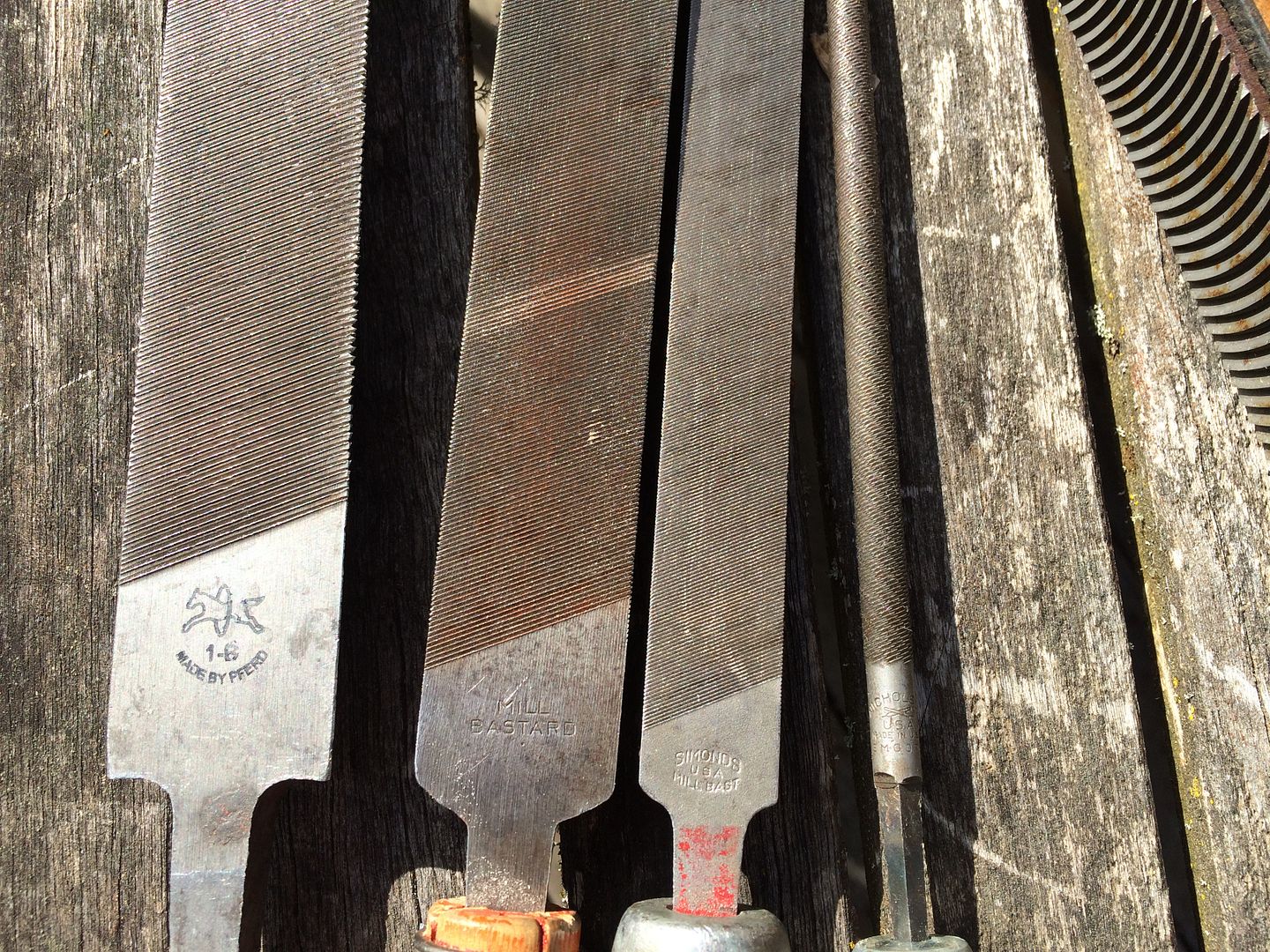

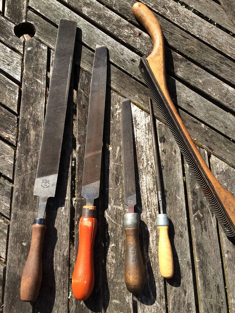

Here is a picture I posted a while ago but since we are talking files again:
I expect any tool that removes hardened metal to wear and eventually need to be replaced. What I don't understand is how these old files keep running while a new one using 21st century know-how will wear away so quickly. Is it poor steel, poor fabrication, or just trash produced by the lowest bidder just to make a chunk of metal with grooves in it and call it a day?
Is it that today, hand tools are made for one project and planned replacement? Like buying a hardware store saw for it to dull after two cuts?
I would pay more for a new file that stands up like the older ones. Quality tools save time and money and produce better overall work - is there a company or product that pros use that I am just not aware of?
