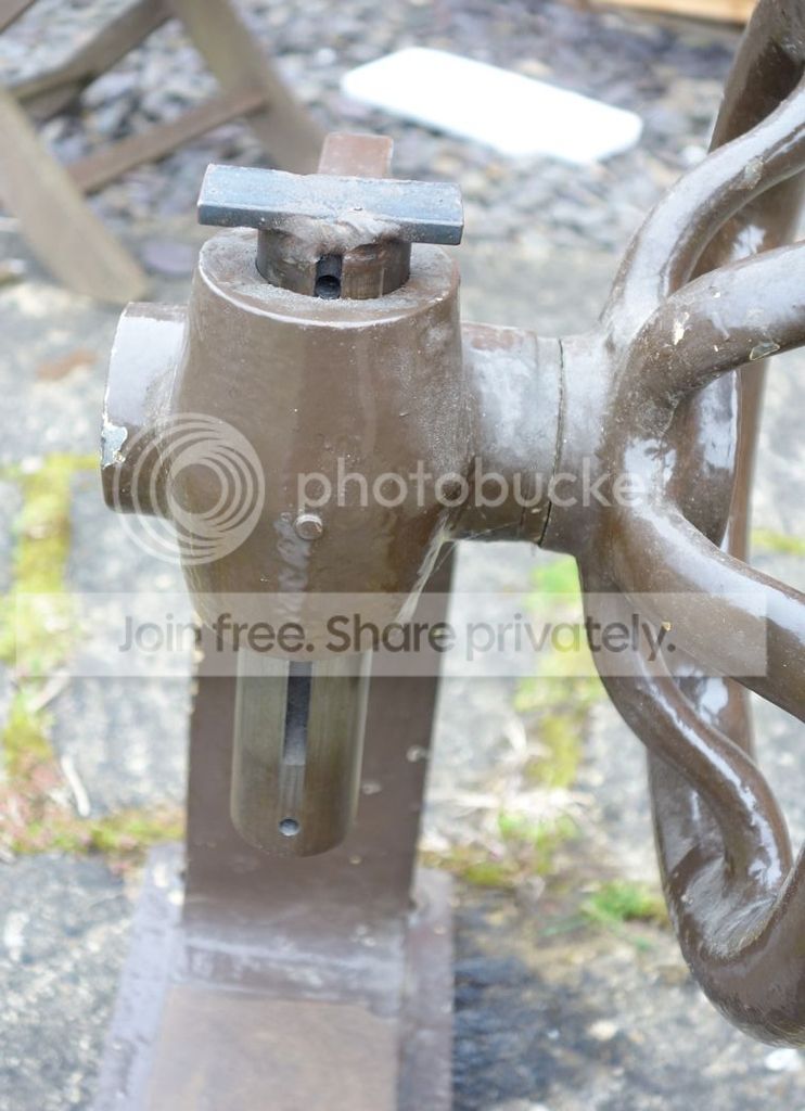

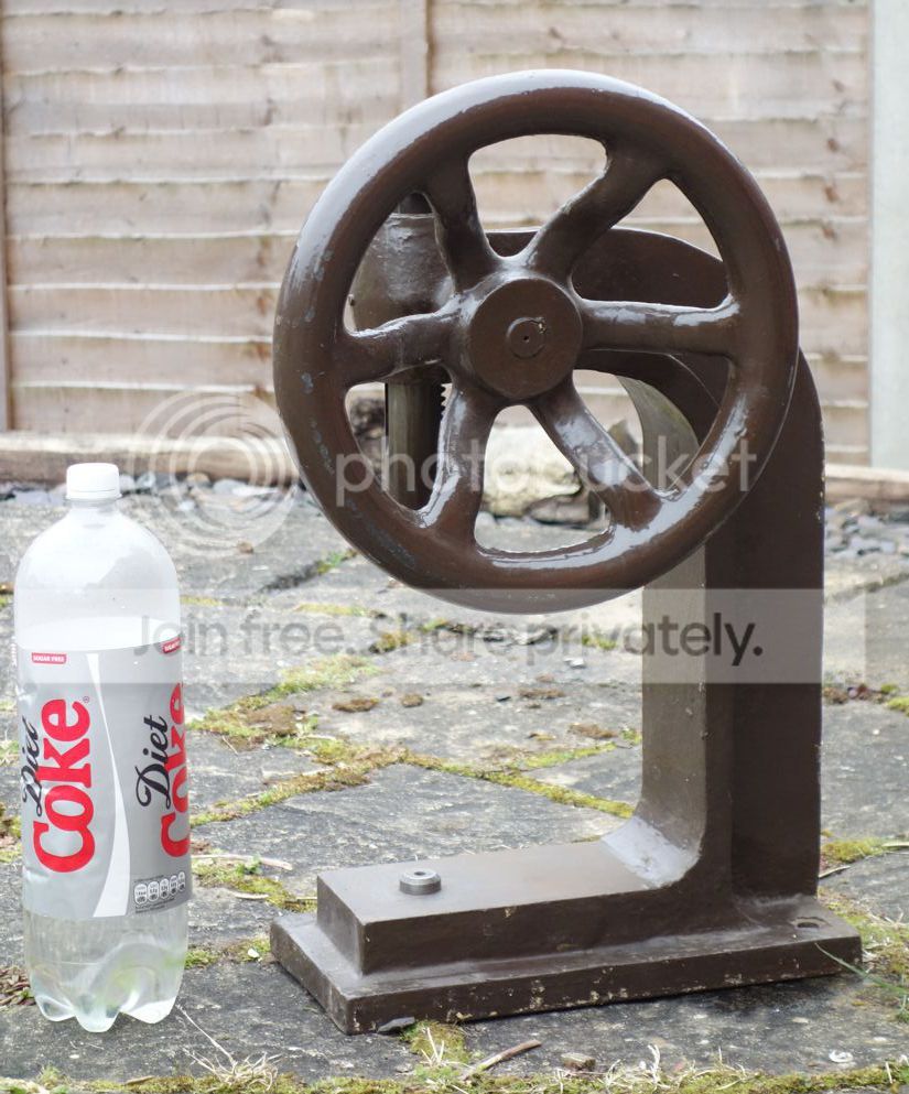

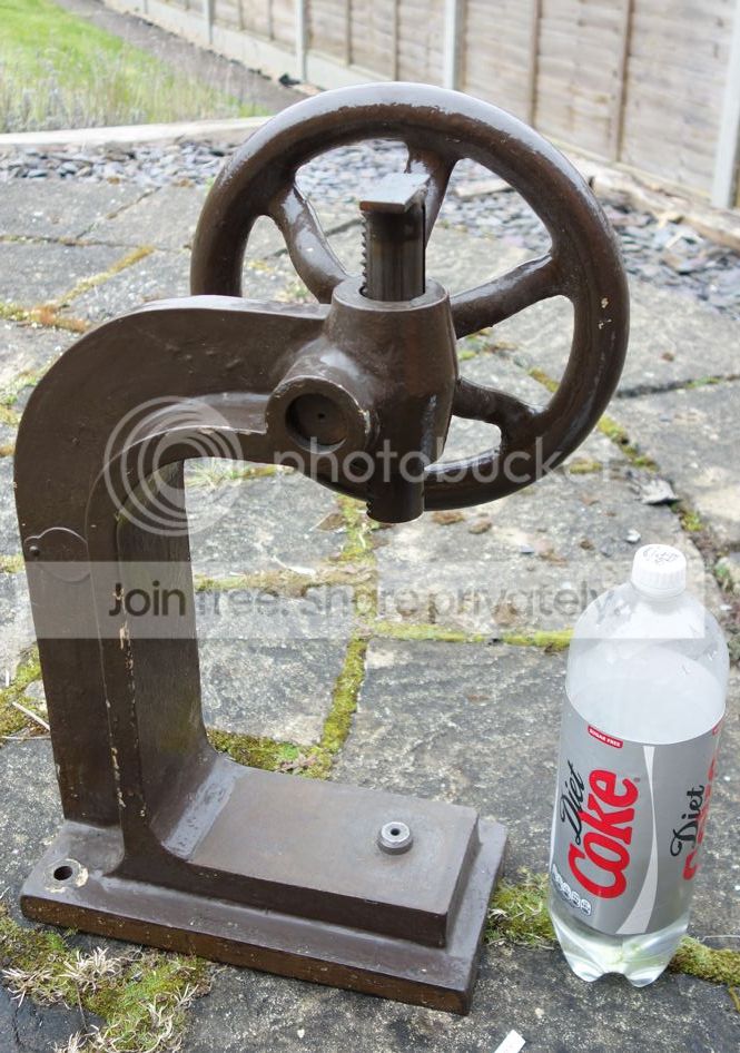

Does anyone have a suggestion for what kind of press this is and more importantly, can anyone think of any knife making jobs that it might be useful for?
I salvaged this thing from where I used to work and it has sat in my shop gathering dust for four years without me ever doing anything with it. This weekend I was having a bit of a clear/re-organize and decided that I should either figure out a use for it, or get rid of it. The latter option had me looking around the internet to find something similar so that I would at least know what it is called! The easy answer would be an arbour press, and maybe a "pilot wheel" type, but I haven't seen a single picture of anything that looks quite like this, so am far from convinced that is its proper description.
The only job that I have thought that it could be used for is flaring eyelets in sheath making, but it is much bigger than the arbour presses I have seen sold for that.
It weights 40kg and I have no idea what load rating it is, just that there is no where for a lever type handle, so all force is generated by turning, or spinning, the heavy iron wheel.

It is called an arbor press. Possibly useful for some pressing tasks, and maybe for stamping, but not much more than that.
Hi Chris - time we had another meet?
It looks to me like a standard arbour press that has been shortened for a specific purpose. The welded on end stop is the giveaway.
I don't think you will get an answer on this one.
C, that is an arbor press--they have been used a lot in Firearm cartridge reloading. It looks like that one was tweaked to only press a certain amount--I've seen that done by folks who wanted to set a definite max that the press would carry, thereby holding very specific tolerances on the creation of a specific (typically Rifle) cartridge. Stacy called it for the knifemaking uses.

You a probably right that it was adjusted for a specific job. That would explain why it was being dumped, chances are that the specific job was no longer required.

Arbor presses can have lots of uses in a knife shop, from setting rivets and eyelets (with dies of course) to flaring lanyard tubes, pressing pins, straightening stock, etc....
That one will be much more limited, unless you can find a longer ram or make a tall anvil to stick underneath the existing ram. You normally don't need much stroke for setting pins, eyelets, or rivets anyway.
Now, you may also find that you'd prefer a lever handle style press for most work too, though wheel handles do have their place.
If you need a press and don't wan't to put any work into that one, keep an eye out for enco free shipping and/or discount deals, and you can get a 1/2 or a 1 ton press for relatively little money.
