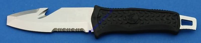

Hey guys, I've been a rafter since I was 5(18 now) and am now a guide myself. Rafting has been in the family for 25 or so years now. For a whitewater knife, you want something that is very grippy when wet, good for cutting salami and cheese...(as that is what it is most often used for) but most importantly, it needs to be able to cut through webbing (rigging straps) thick rope, clothing, and anything else that could cause entanglement if you were a smimmer. I like a serrated blade. Spyderco's salt or rescue series are favorites of mine, though I've been looking for a good fixed option for ease of deployment.

I'm not a whitewater "guide", but I got me a brand new Benchmade water knife en route for all my boating, diving, rafting, "Katrina" adventures...

Have you had a look at the enuff or the jump master?
Any knife on the spyderco H1 rustproof line. As mentioned above, Enuff or Jumpmaster for fixed blades, the Tasman, Pacific, or Atlantic Salt for folders. Can't go wrong with those blades. Serrations will be helpful if your concerned about tangles.
Some guys like to run flat tips/sheepsfoot blades, I like the ability to stab through raft material if necessary.
