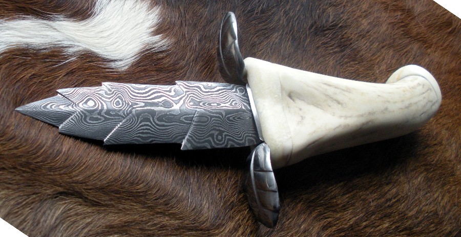

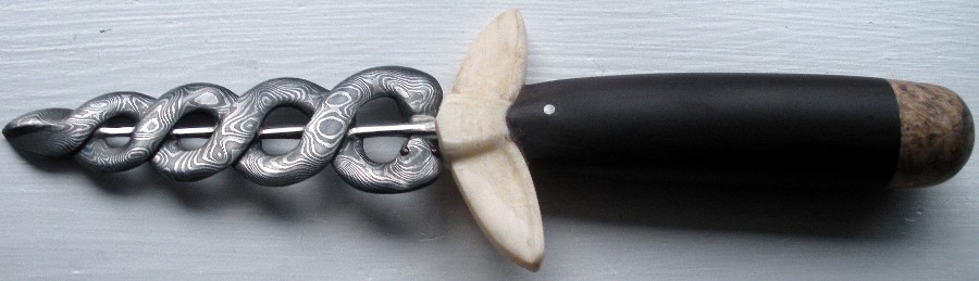

Ironically, it was my earliest projects that pushed me the farthest, probably because I had not established what my comfort zone was, and I was MUCH more experimental then.
As I look back on things like the Leaf Knife and the Caduceus Knife, I find myself wanting to try my hand at those projects again (as impractical as they both were) to see what I might be capable of today on similary off the wall designs.
Those are crazy awesome. I am currently tipping my hat in your direction good sir!
