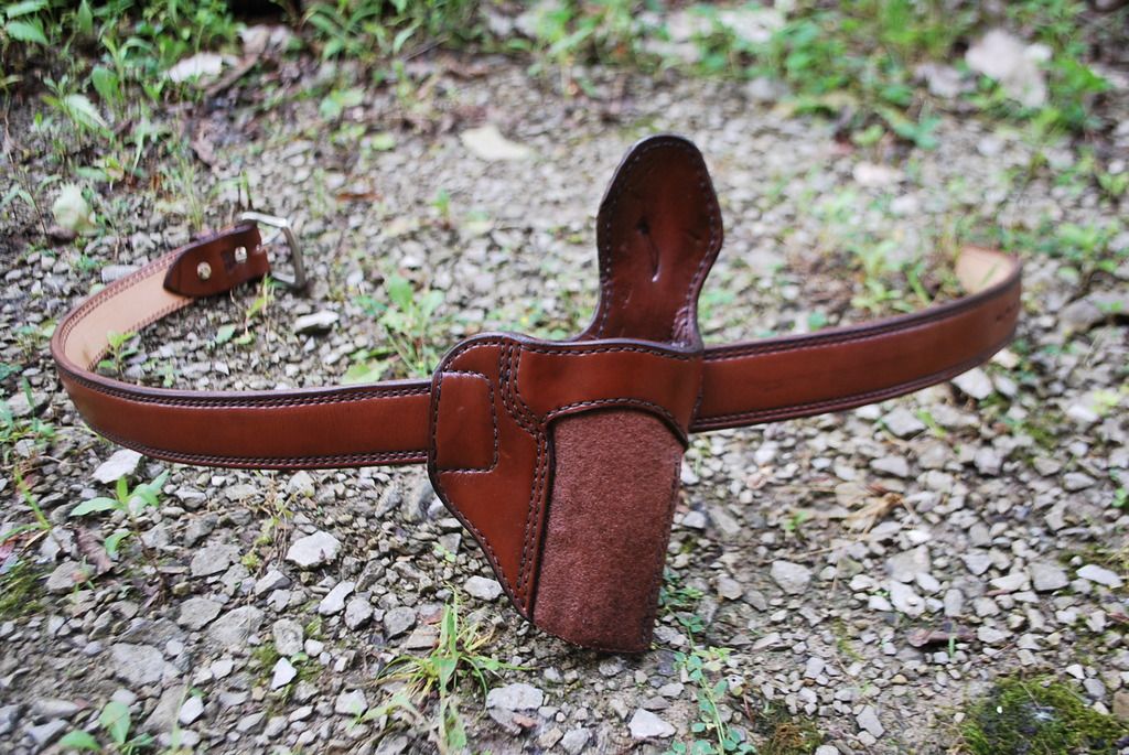

got really agitated a week or so ago when I went to take this somewhere and didn't have a holster for it. The 640 Pro was a wedding gift from my brother in law.....in March. Hopefully it didn't leave him feeling under-appreciated going so long without. The holster I made sports a caiman reinforcement panel and has a new 1.5" lined and stiffened belt. Last belt I made myself was made in 2012, so it was time to start breaking in a new one for nicer occasions.
Nice rig :thumbup:
Can you explain " the belt is stiffened " , have you put something between the liner and the outer ?

Ken, for heavy use belts or competition rigs that are toting a lot of weight I will stiffen them. Some makers sandwich pieces of kydex in there, some use metal strapping/banding like you ship things with, I've seen a lot of different things used. My pick is plastic pipe hangar/tape. It's lightweight plastic and stiff while remaining flexible and will not break like kydex will after getting twisted a lot. During construction I simply mark where it needs to go and glue it in before gluing in the liner. I like that it is roughly 5/8" wide so it fits between both rows of stitching and leaves the center with a 'raised' look you see on a lot of dress belts.
I released that option in May and have sold a couple dozen that way with rave reviews. This is a better example of one with something to compliment your rough out challenge.
Hmm thats a good idea Eagle I've used nylon webbing in a leather sandwich for hobbles. Helps buckle holes tearing out when training a colt or if they get damp from grazing in a dewey meadow. Always enjoy pics of your work.

PS - thanks for the belt explanation , is the stiffness require to spread the weight - load to make carry more comfortable , or is it to stop the belt deforming ?

Ken, thanks! That rig will actually be in next months 'Fall Special Edition' of Guns' Magazine, the article revolves around hog hunting with a 45ACP and holster was designed specifically to fit that customers needs with free reign on my end for design elements. From start to finish we had to have it done in 2 weeks which included my R&D :eek:
No problem on the belt explanation I hope that it helps someone. You hit both highlights on the reasoning behind it. A 1911 unloaded is appx 40 ounces, when you add in 2-3 loaded magazines, some folks pack, or 4-6 for competition use it is easy to lose your pants without a stiff belt to help distribute the weight.
Another place that method of construction really shines is on 1.25" carry belts. Folks that wear dress attire can't stuff a 1.5" belt onto most suit pants, so the reinforcement gives a little backbone to help prevent tip out of the handgun which is the #1 problem for folks that complain about a handgun printing.
