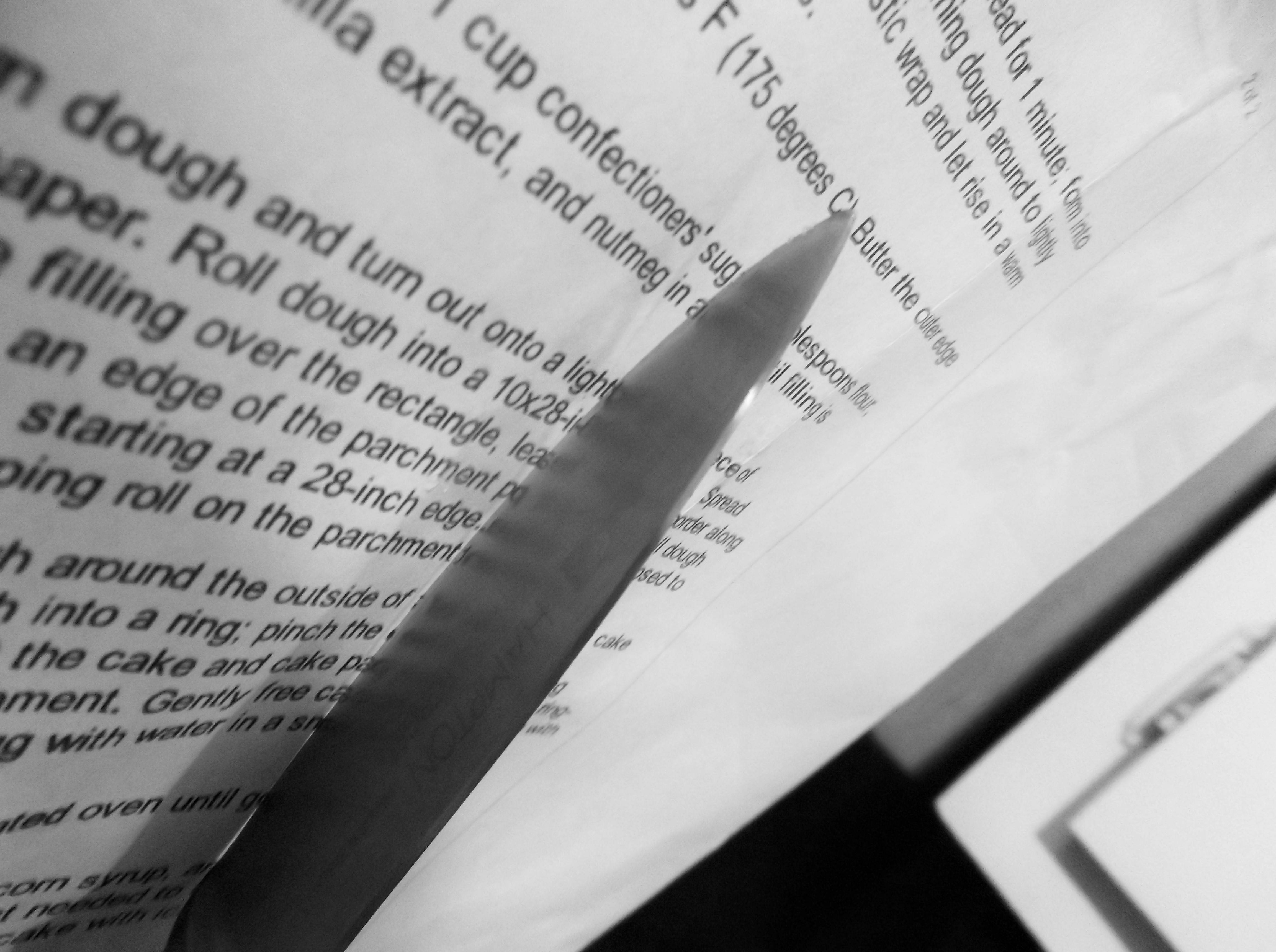

Add some compound to the strop and it'd work out nicely. This knife was finished with soft arkansas and white compound.
Bit hard to see because my camera is a piece of crap but it reflects letters on a piece of paper and will tree top hairs.
