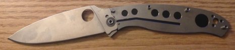

When downward pressure is put on the blade of a liner lock, force travels through the tang and then directly onto the lock bar, with nowhere else for it to go. Because the force is directed straight back, if the lockbar is too weak (or as oxman said, the interface becomes too slippery), it can get pushed right out of the way.
A compression lock is very different. The force travels through the lock bar, straight up, not back, and into the stop pin. It is called a compression lock (presumably) because the lock bar is compressed between the tang and stop pin. So even if the interface became very slippery, I doubt you'd end up with a lock failure like you could with a liner lock. Maybe it could happen in theory, but I think the same circumstances that would cause a liner lock failure would need to be significnatly multiplied before they'd cause a failure in a compression lock.

Nice!! So clear!

That is a great explanation!
