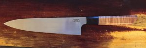

This is my most common profile. It has less belly than some other very popular designs, but it requires very little lift at the heel/handle for rocking. It gives up a bit in the push cut though. This one is 0.090” with a full distal taper. 210mm blade. Balances perfectly at the pinch grip right in front of the bolster. It’s cru-wear at Rc64 iirc. Super sharp.
