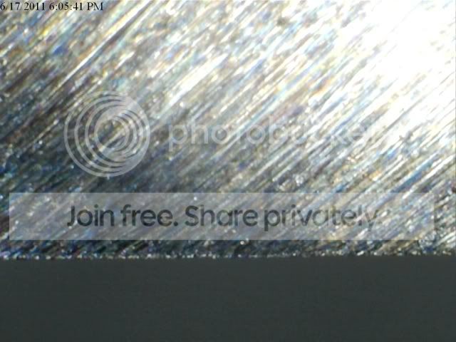

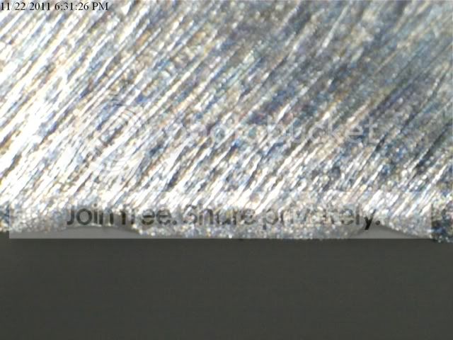

i got to thinking, i wonder how CPM-M4 would handle hitting a staple. then i decided to kick it up a few notches and see what would happen to CPM-M4 under worse than just a "hit a staple" scenario.
i used my M4 manix2 for testing. the bevel is around 15-18 degrees per side, sharpened on a 1500-2000 fine ceramic stone and lightly stroped with 2-5 micron white buffing compound.
for the test i used the bottom of a coffee can and decided to cut through the rim.
it took three tries, i changed the angle while i was cutting it. as you can see i used a lot of pressure to cut through the rim, much more than anyone would ever hit a staple with.
here is the edge before cutting (375x)
here is the edge after cutting (50x)

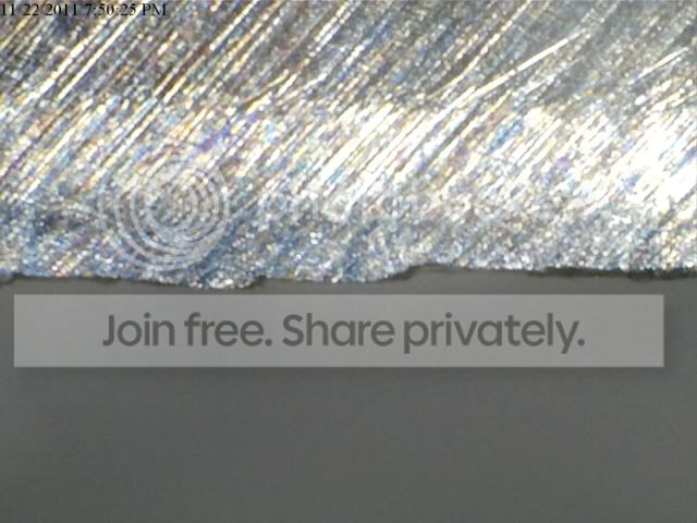

here is the edge after cutting (375X)

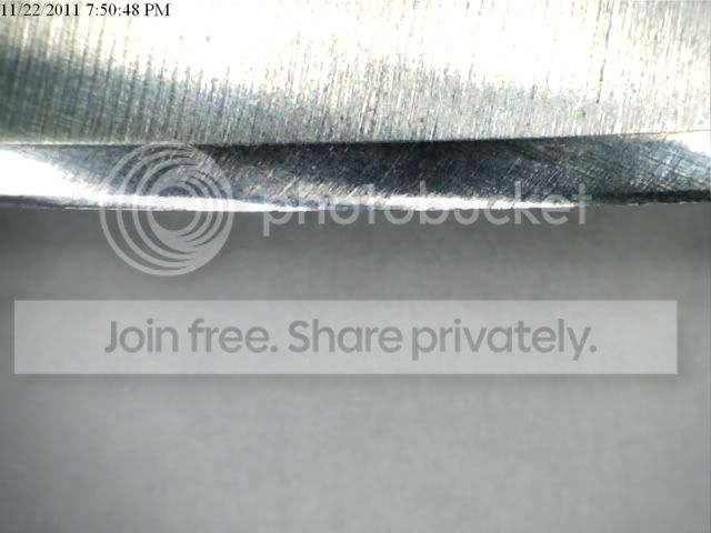

here is the edge after i gave it 30 swipes on the fine ceramic (15 per side) and 20 strokes on the strop (10 per side). re-sharpening took maybe 30-40 seconds.
at 50x
at 375x
the knife shaves stubble off my arm and push cuts thin newspaper after sharpening.

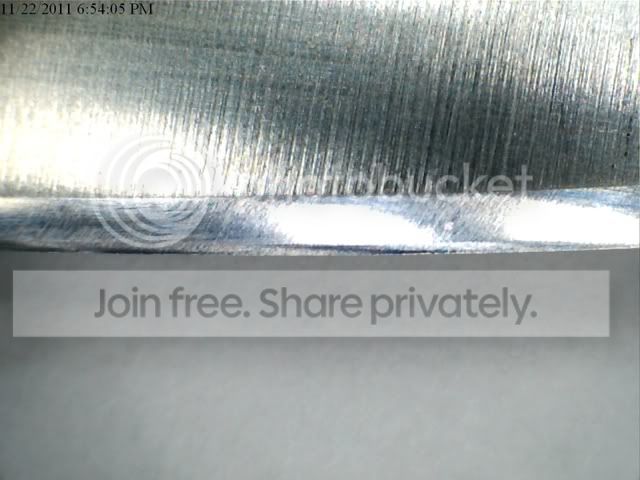

i decided to baton the M4 manix2 through the coffee can rim. so after plunging the knife through the steel and batoning it, the CPM-M4 still cut through thin newspaper.
here is the edge at 50x
here is the edge at 375x
i re-sharpened the blade, 30 swipes (15 per side) on a the fine ceramic (1500-2000 grit) and 16 strokes on the strop (2-5 micron white compound), i can't find any evidence of what i just did.
here is the spot at 375x
