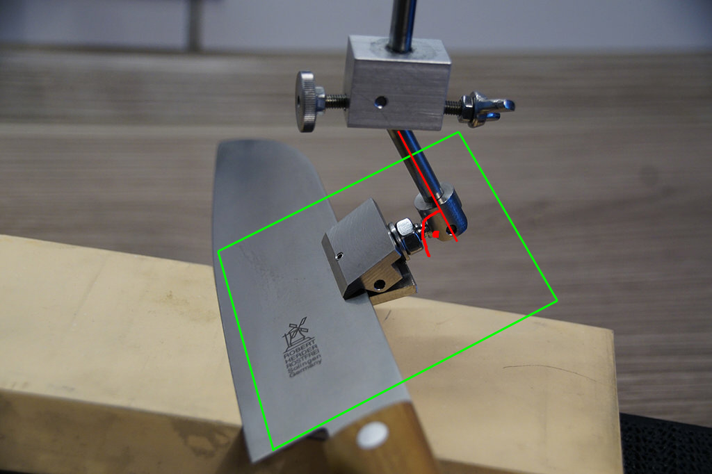

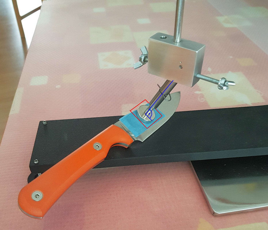

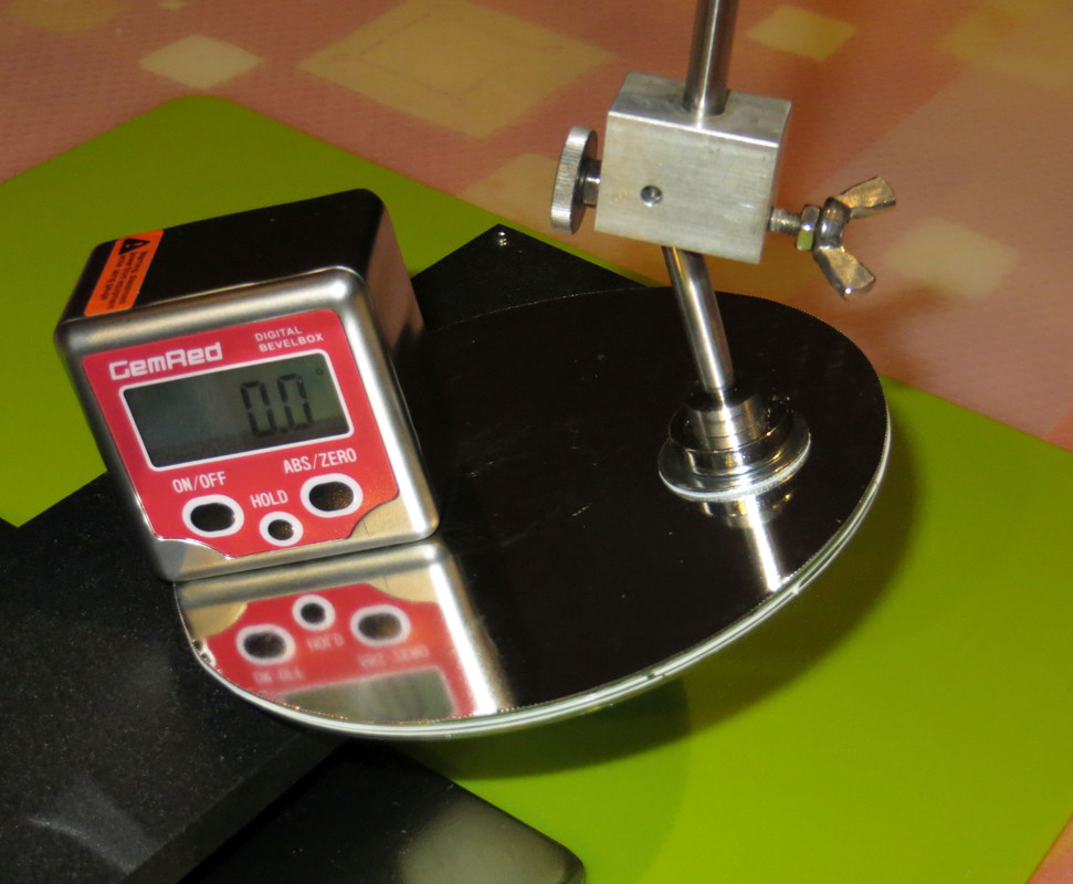

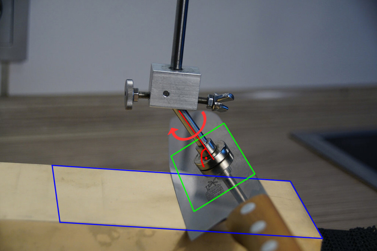

Unfortunately, the systems you mentioned do not have the feature that they hold the angle constant by it design.
There are ways to compensate the change of the angle to a certain amount with these systems, but it requires measurements and/or adjustments.

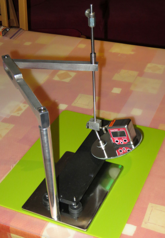

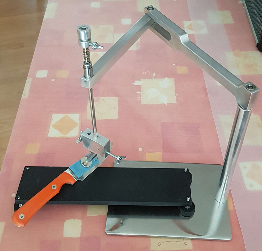

Only the NOWI and similar systems like the Bogdan who was the first who offered such a system, keep the angle constant over the whole length of the blade, even if it has a radius to the tip by it principle of design.
This fundamental difference in the design is the rotating axis (blue in the second picture and red in the third, fourth and fifth) going perpendicular through the plane of the blade (red in the second picture and green in the third, fourth and fifth).
This rotating axis going perpendicular through the plane of the blade is the genius of this principle.
Pictures below are showing a Bogdan system.

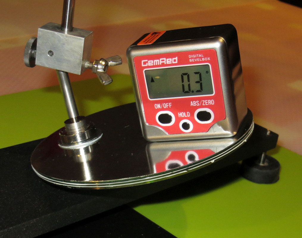

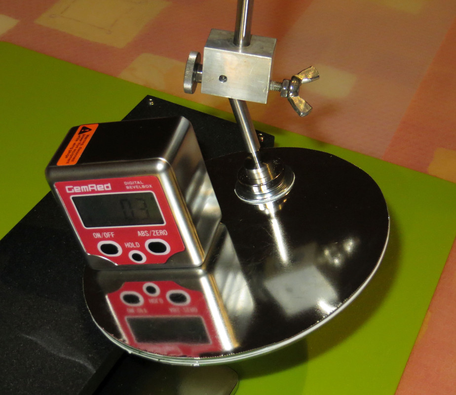

No, the Ermak 10 does not have a design which automatically keeps the angle constant.

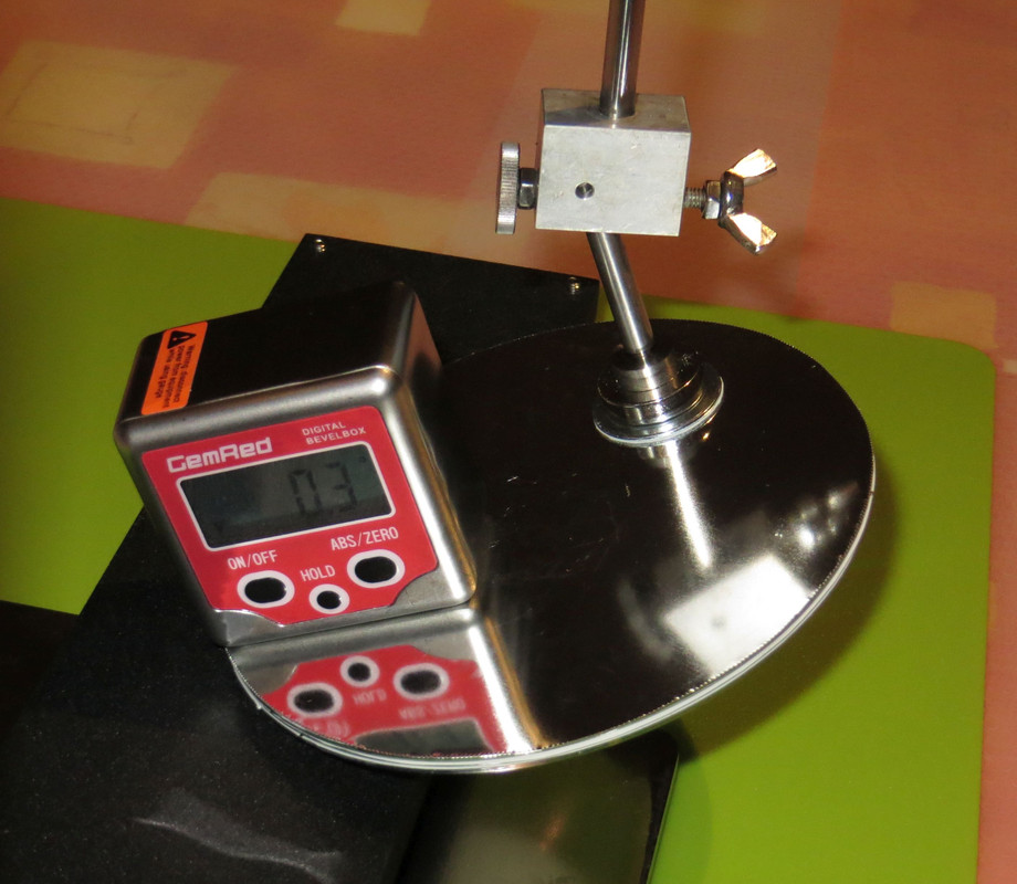

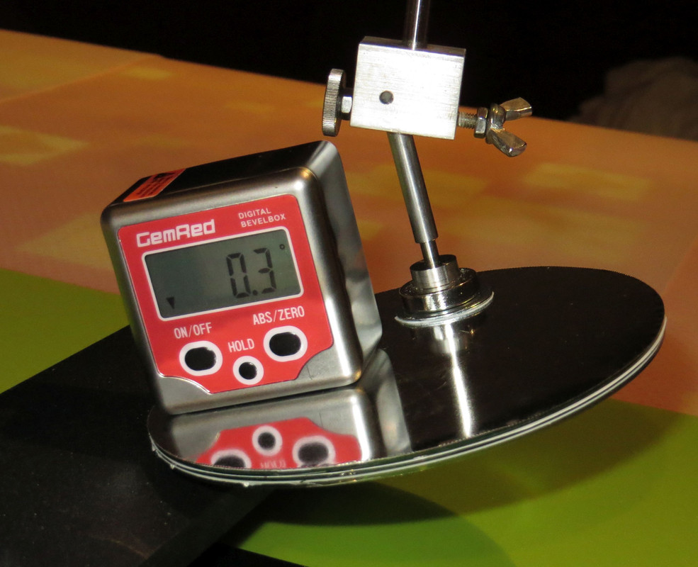

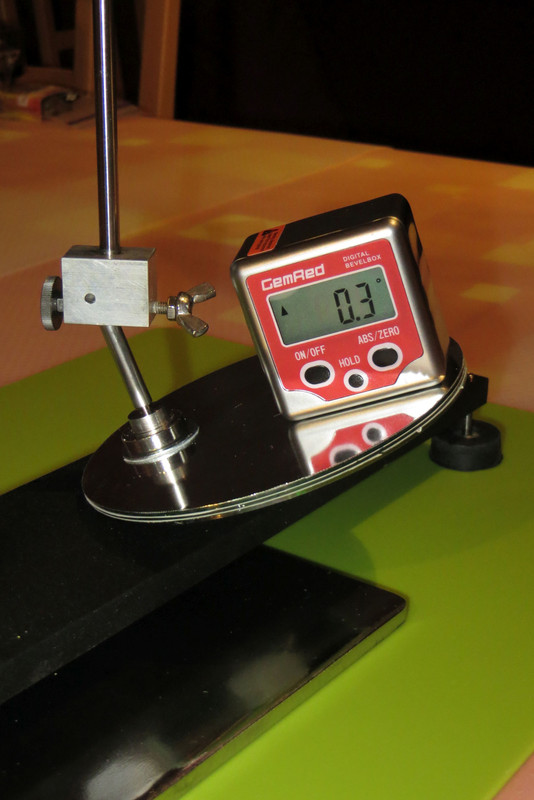

The big advantage which the NOWI and Bogdan Systems is that you hit the same angle every time when the angle is measured the same as the last time you sharpened the blade.
With other systems, it is very important to put the knife in the same position in the system every time to hit the exact same grinding angle.That is very complicated and inconvenient.
For me, it works best to figure out if a system is able to keep the angle constant no matter what the knife looks, I imagine how it would perform to sharpen a round blade.
The 0.3° variation in the pictures is because of the setup and positioning of the digital angle gauge on the plate and is negligible in my opinion.

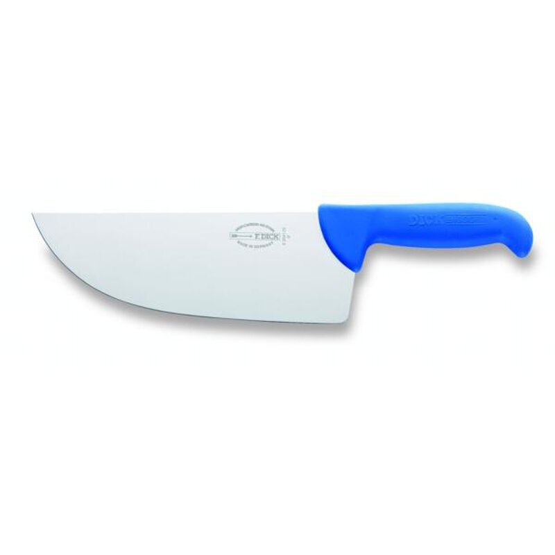

A knife which comes closest would be something like this:
Very good! With all your pics, I now pretty well understand the NOWI and agree it achieves a consistent and correct angle. I spent some time looking at the available info on the Ermak series but was unable to understand its theory of operation.
