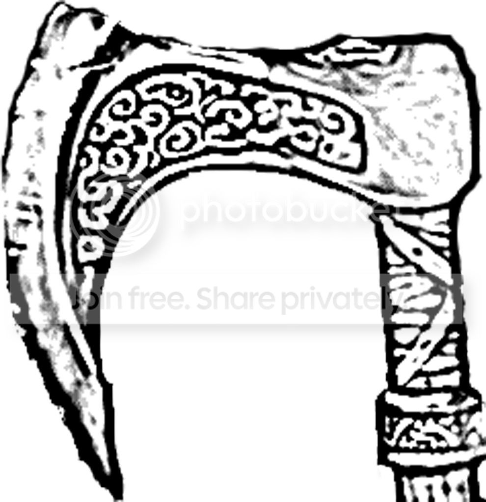

I've sourced the material for the my first knife, and am picking up my belt sander/grinder next weekend. I've already started drawing up my second project. How much should I expect to pay for a piece of 5160 that is 1/2" thick, and 9x12

nope. i meant 1/2". not going to be a knife. think more along the lines of bearded hawk....

1/2 inch is still a really thick hawk. I think I would personally go with 3/8ths (as he hints at a future project).
I would use 3/16" to a max of 1/4" for that hawk and do a wrap and weld style. If done in 5160, there will be no need for a bit to be added. Forge the wrap around a 1" steel rod, weld the joint, upset and angle the face/cheek to start the heel/beard, draw out the beard, drift the eye, do final shaping on the grinder, etch. This will be a lot of work, but an experienced smith should have no problem.
If you have a power hammer and the tools ( and experience) you could draw out a piece of 1X3X3 into that axe.
All that said, the project you have drawn is a task for a very experienced metal worker and smith. The decorative work can be acid etched in for a rustic "Antique" look.
