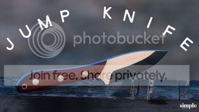

I'm trying to get all of my ducks in a row before ordering. What size do these pins look to be? Also, what is being used, or could I use, for the lanyard hole? I think the knife is around 7.5-8 inches and I also think that the blade is about 1 inch wide. Hopefully that will provide some scale.

No other reason for them to be so large on such a small knife if they don't have shoulders.
That lanyard tube looks like 1/4" and the corbies are bigger then that:cool:
Seamless tubing

Thong hole

I feel the pins in the photo you show are too large, but if you want to know, message the dude, Jeremy?
I bet he tells you .
You're definitely right, this was just his interpretation of the classic. They do look large but I just dig that on this one.
I did ask on the comments section of his channel but no luck yet. I'm sure some of those guys are swamped.
I don't really want an exact copy of his either, just to be in the ballpark.

I got a response via instagram
"the lanyard tube is .250" (a little small but all I had on hand) and the pins are .314"
