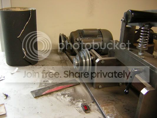

This is my KMG setup:
It is 2HP single phase. Using the 4 step pulley this way you don't need a hinge setup and you get a good speed range. This is 1000 SFM (slooow) to 5000 SFM (faaast). To change speeds you roll the belt onto the smaller cog, then roll the other side up onto the larger cog, the developed belt length is the same between for all four speeds. It takes only a few seconds to change speeds and it has never slipped on me.
