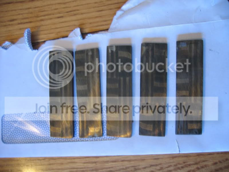

Frank this is what I made the other day, I stacked the bars wrong but I still like the way it came out. I could do 5,11, or 13 layers for the same price in either of the patterns. Now is just need to figure out a fair price.
This was the pattern I was going for.
Also I am thinking of including a little pure nickle in my work. Maybe a month down the road if all goes well.

Dan,
That looks like a large basket weave pattern.
