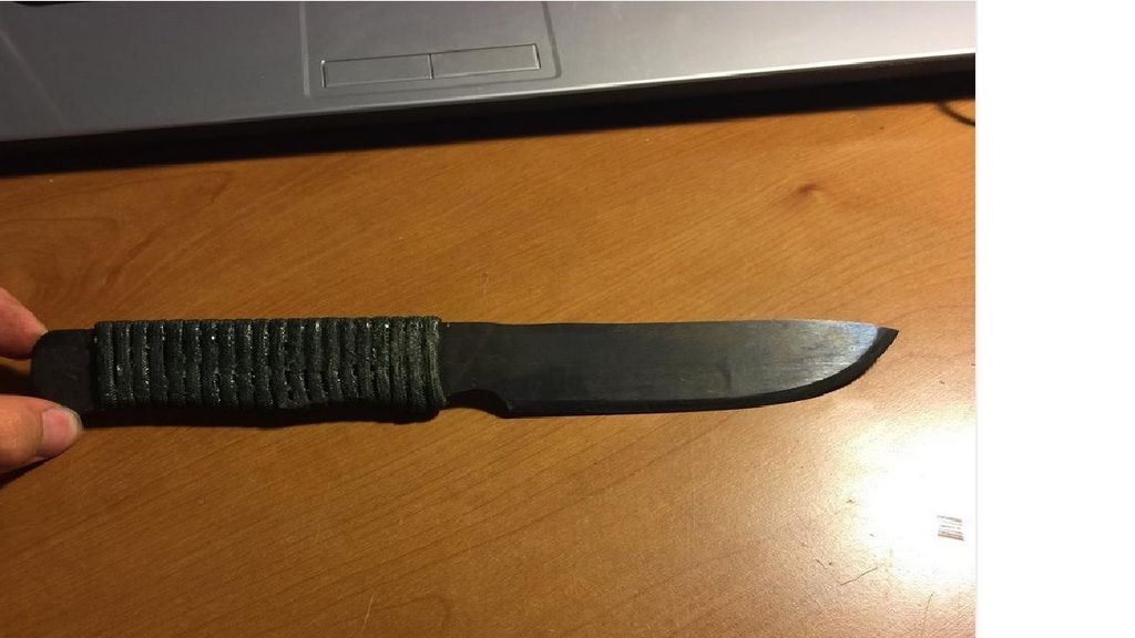

http://i556.photobucket.com/albums/ss3/Anthony_Strazhnikov/Knife_zpsfiso66t7.jpg?t=1439782842 Here is my first ever knife that I finished today. I don't know if its any good because I used a piece of steel I bought at a flea market so I doubt it will hold an edge.
great effort! it looks almost exactly like my first knife! (i wonder if we all make that type first, you know, straight spine, sharpened edge but not a tapering grind, low quality "mystery steel" paracord not scales etc. and then pain the blade black) in fact the only aprecciable difference is that my paracord was red! also you might want to try making a folder from an old kitchen knife, i say a folder as they almost never have a full tang, you can even do this with an old butterknife (the kind that you can buy for pennies each at a charity shop (thrift store if you're american), i did that as a way of practising and it really helped me improve. hope this helps.
