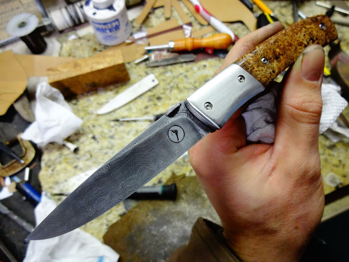

The hunter blade after etching and a little bit of sanding. My new torch in circle mark for damascus blades, and irregular mark locations. This didn't etch quite at deep as normal, due to a new batch of ferric chloride that I have to tweak a bit.

Question on the hunter. It's a hidden tang, but on the glue up picture it looks like 2 piece scales. Is there any benefit to doing 2 piece instead of one? Do you router one side or both sides so that the glue joint is in the center?
In this pic you have radiuses where the tang meets the ricasso. Do you square them up to fit the guard or leave then as a radius?
I leave them as radii. Makes the knife stronger. The guard slot has its corners filed to fit the tang shoulders.
Both sides of the grip wood are routed, so that the tang lies down the center. Sometimes I do it this way, sometimes I drill and broach the block without splitting it. It depends on the workflow, sometimes one makes more sense than the other. This method really shines when you have got a synthetic hidden tang handle, particularly G10, which sucks to drill and broach.
