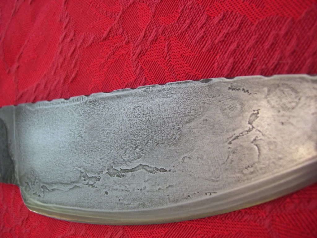

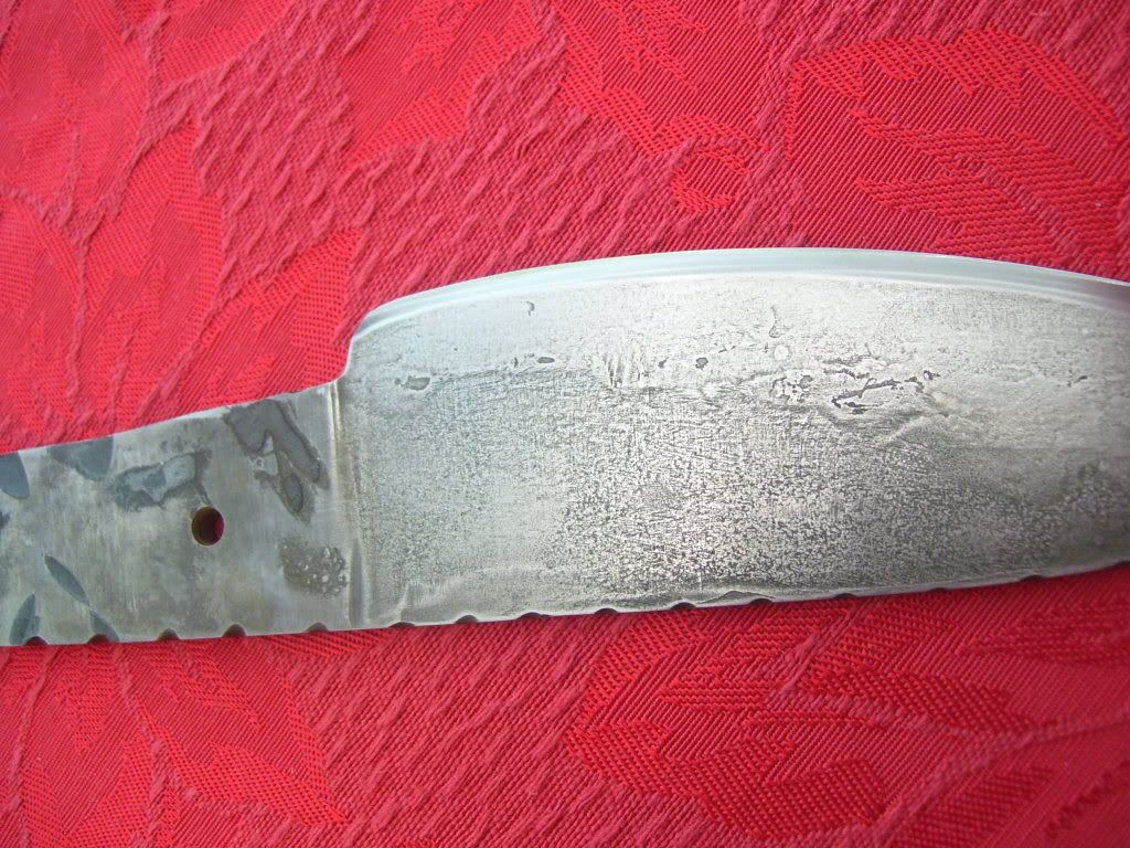

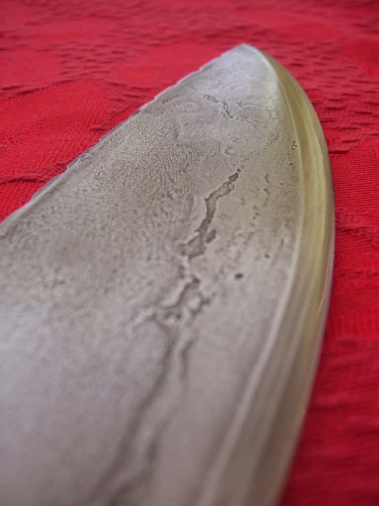

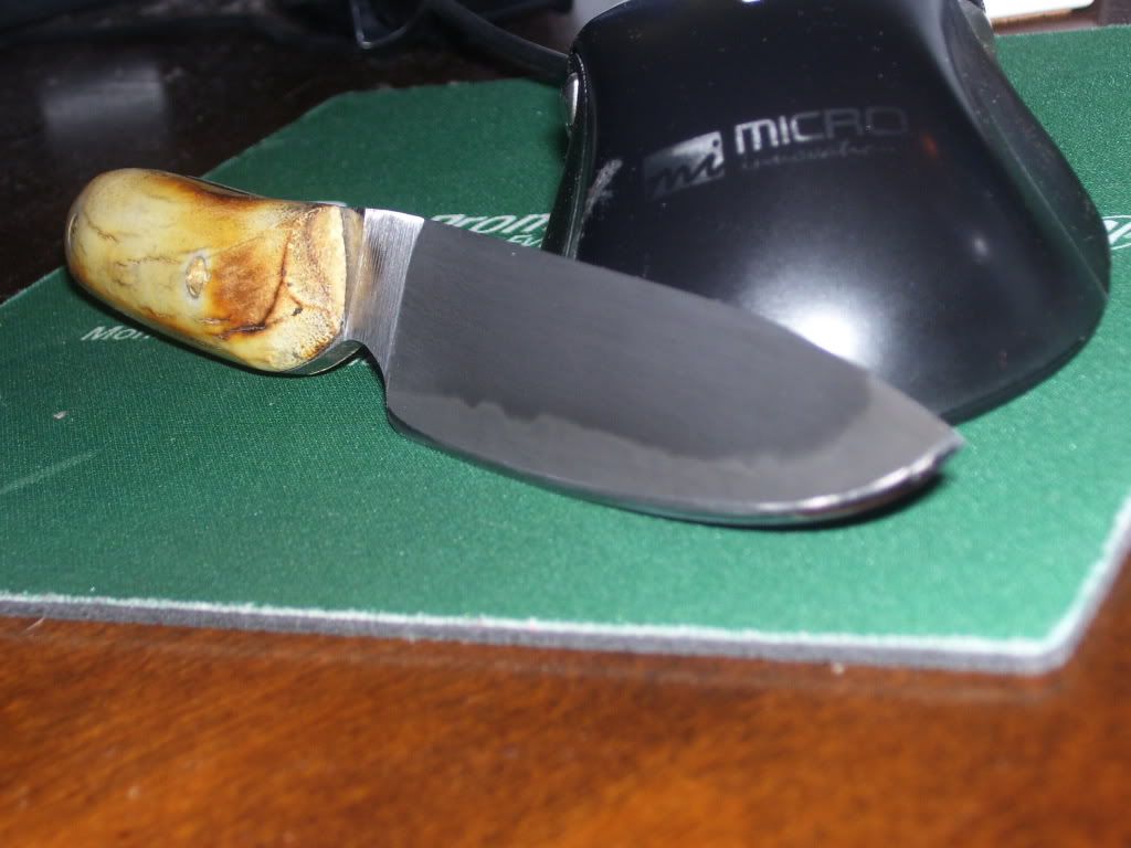

I just got this one forged and heat treated. After heat treat, it was taken to 400 grit and vinegar etched. Looked great before, and in my opinion it looks great now, but I'm afraid not everyone will appreciate it. It's a very busy hardening line. Not at all what I expected. I like it, but I wanted to present it to you guys. It looks grainy and platey, almost like I left scale or decarb on it. I didn't. There was a lot of stock removal after forging and a nominal amount after HT, and the hardness checked out with a file right after HT.
Here's my procedure for scrutiny;
It's HR1095. I forged in the as received condition.
Forged to as good a finish as I could muster. Left the edge at least 3/32". Took about 10 heats on the blade. Not a terrible amount of scaling.
Normalized x3
Process annealed. Got to normalizing heat, shut off the forge, closed both ends, threw Kaowool blanket over whole forge, then covered with moving blanket and an old coat. After 9 hours it was still very hot to the touch.
Ground bevels flat, took edge to 1/16" and did file work. Drilled holes in tang. Ended grinding at 400 grit, which is as far as I ever go on a working blade, although I do hand rub the 220 and 400 after HT.
Clayed blade with soupy potter's clay. Dried in front of forge. Very dark area is where it was clayed. It followed the outline fairly faithfully.
HT was a shade above non-magnetic. No soak. Interrupted water quench; in, out, in, out, in. After the third dunk, I left it until cool.
Tempered at 400 for 2 hours.
Back on grinder for finishing. Took little metal off. Only used 220 and 400 belts.
Vinegar etched in almost boiling white vinegar with some soap in it for surface adhesion. Total etch time was ~10 minutes. Rubbed clean with 400grit every 30 seconds - 1 minute.
Pay no mind to the edge. It is the start of a convex grind, and was done right before final etch. I stopped working on the edge after the character started coming out, as I was trying to figure out what was going on.
Did I etch too long? Did I not take it up to a high enough finish before HT or after? Did I muck up the HT? What caused this look?
