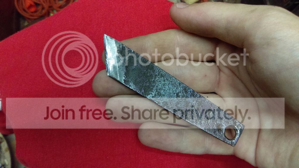

I found what used to be an old 6" Nicholson in my yard yesterday, and made a 1hr project out of it today. The results are a 4-5/8" kiridashi to put in my toolbox, it's not perfect but it will certainly work.
I hope you guys like it, and maybe it will inspire some of you to try the same thing
( all I used was a torch, single cut mill bastard , drill, and sharpening stones )

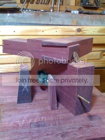

Those curved files used to be straight until I heated them, bent them and rehardened and tempered.
The half finished wood working plane blade used to be an old scrap yard file; until the angle grinder got to it.
And last but not least a woodworking layout knife. Hollow flat back ala Japanese tools, mirror polished both sides of the chisel grind. I left a portion of the file teeth on for grip.
For laying out knifed precision layout lines for large joints like these.
