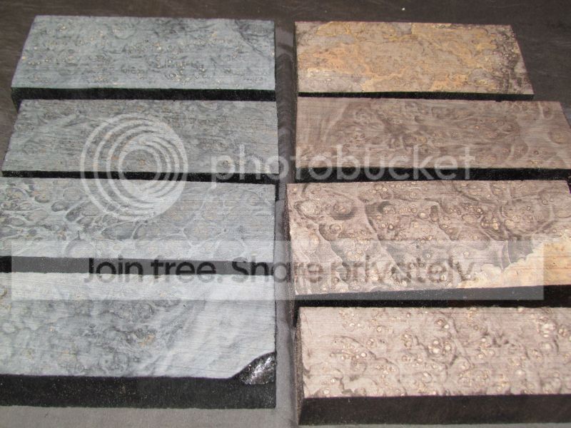

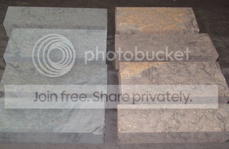

The wood here was dyed and stabilized for me by K&G, (Knife and Gun Finishing Supply). I have been delighted by everything they have done for me.
All of these pieces are maple burl. All cut from the same burl. All of each color were done in the same batches.

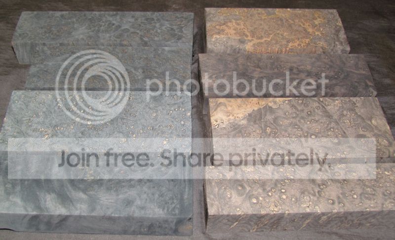

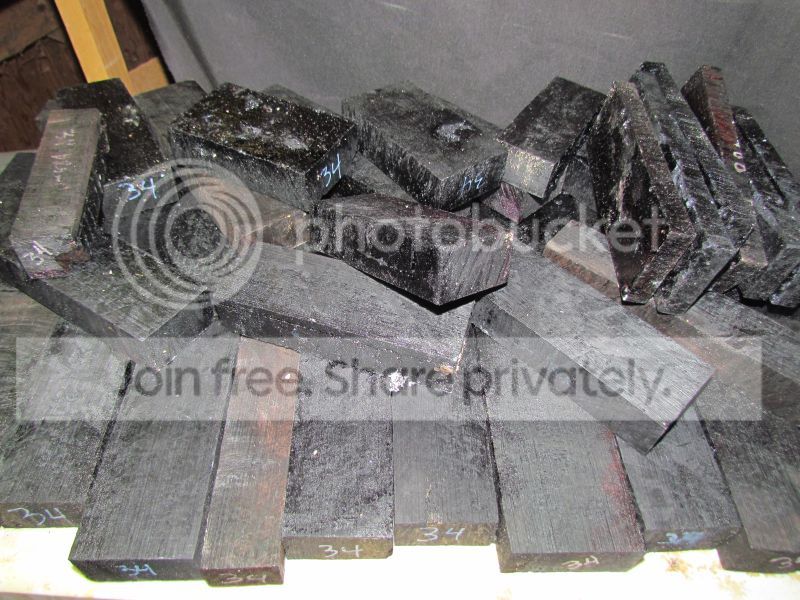

When the wood first comes back from being dyed first and then stabilized it looks like this. Very dark.
The exteriors are covered with gunk that may be a little sticky. This is excess resin with some pigment from the dye.
That outer rind is what causes most of the clogging and gunking up of your sanding belts. I remove the exterior with my sander using very course 36 grit. If you go much finer the belts or discs clog faster.
Then I go to 120 grit with the stationary belt sander.
Finally 220 grit with a palm sander.
You have probably noticed the blocks looking a little darker as you get to the finer grits.
That is because the coarser surfaces reflect the light differently hiding a lot of the color.

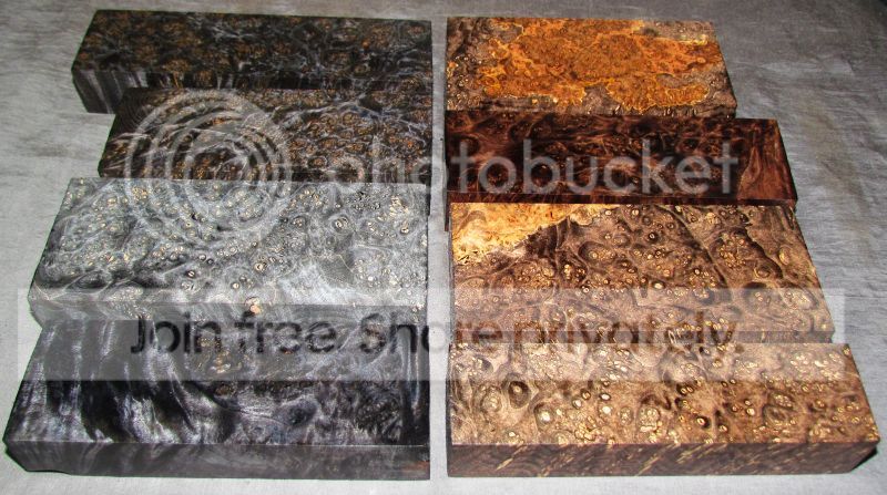

As you get a smoother surface the coloring and figure begin to stand out a lot more.
This is 220 grit and sprayed with a light coat of lacquer. Not quite as nice as it will look when a handle is properly finished. But enough to show some of the potential.
