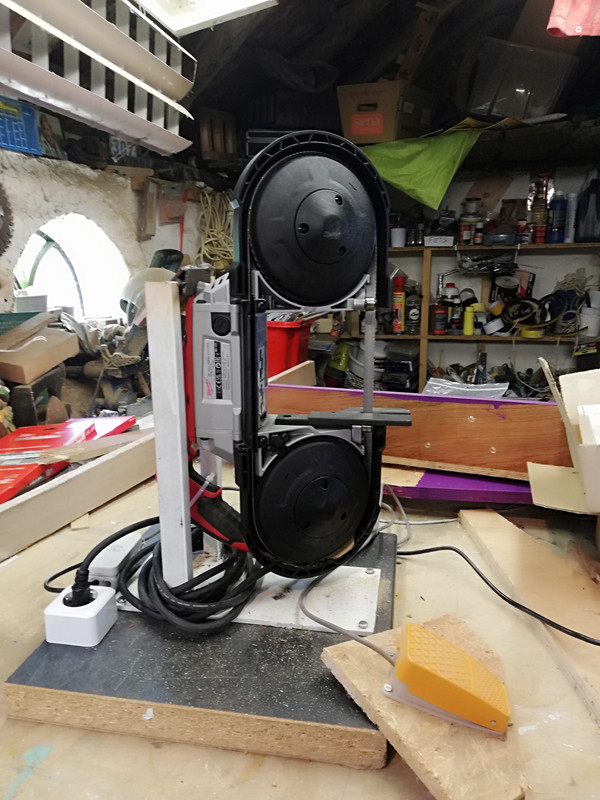

I got the machine today and it is a different league then the cheap one I had before.
This one is build to use and build to last!

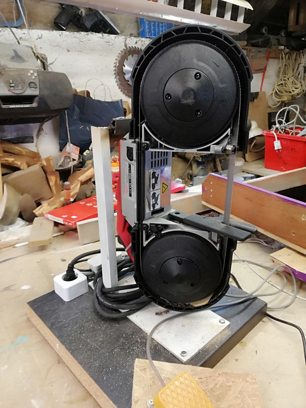

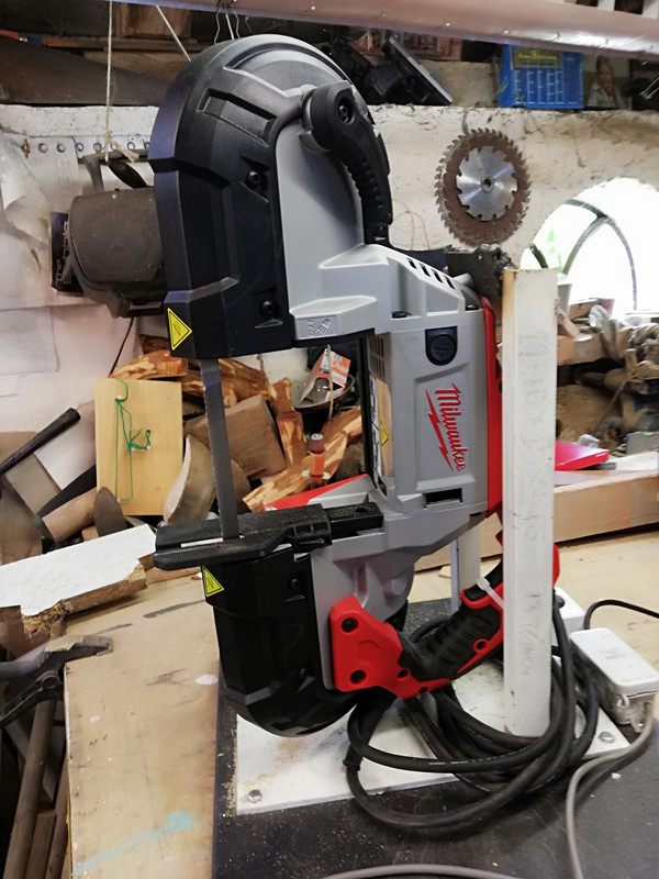

It has a handle on top held by a large screw that can be screwed off and used to mound it on a fixed construction. I even managed to re-use the construction of my old machine. I made it so that it runs when you stand on a foot pedal.
I do want to build a table around the blade but I'll use it for a while first to see how I want it exactly.
I'm very happy with this machine!

Very cool. I love my portable setup and use it almost exclusively now for bandsaw task. You can also easily remove the OEM guard and replace with a larger flat table style if desirable. Easy to find these online aftermarket.
Those portable banjos are sweet when your fitting miles of pipe. I've got a delta in the basement for bigger stationary work.
