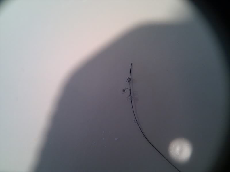

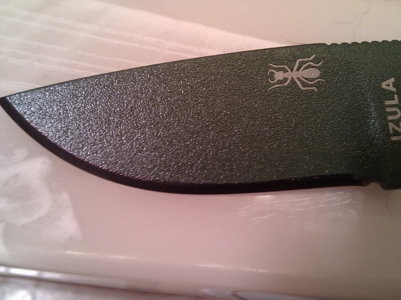

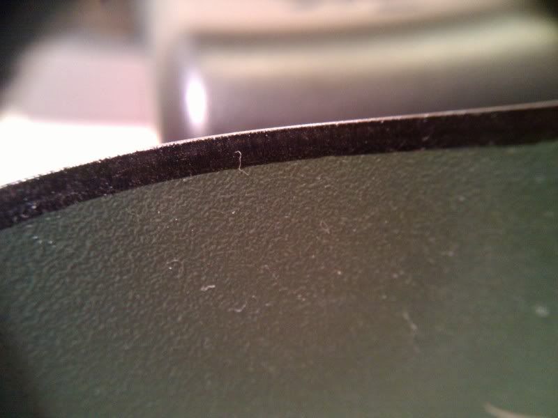

Make sure you watch the DVD at least twice. Then make sure you use the sharpie method where you mark the entire blade. This way, you can see where you are hitting the edge. It might take you a short time to get over the initial learning curve, but don't get discouraged. There is a reason why this system is so popular. FYI all my results are done at 20º setting on the sharpmaker.
Mark the entire edge like this.
You want your knife to get these results. You are only removing metal at the very edge and thus are sharpening the edge and not the bevel.
Eventually, with very light strokes on the UF you will get these results.
My small insingo.
Look at those tiny Curls :thumbup:
