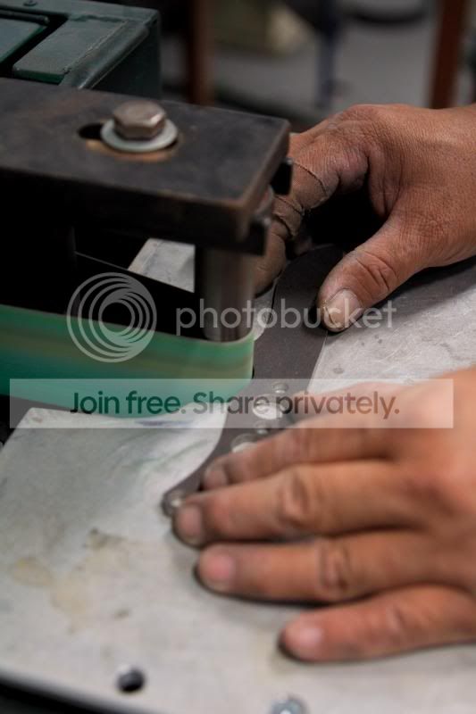

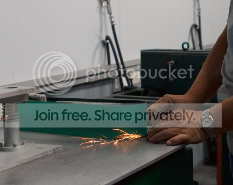

Our Surface grinder
Grinding the blade bevel

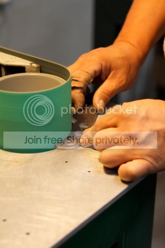

Choil Finishing

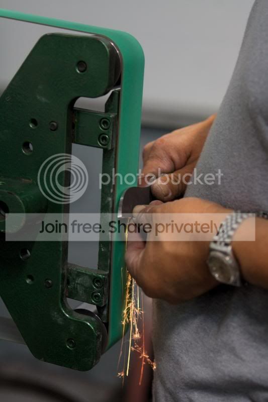

Spine and Handle Finishing

Zap, what you're looking at is something that approximates a surface grinder, and it is a great idea the way Dick set it up. The grinder is fixed, while the knife is held in a magnetic chuck on a multi-axis machining table that moves the blade under the belt. It is for creating a true flat and for precisely controlling thickness.
Dick, how do you adjust the knife against the belt vertically to bring the knife in contact or change the grinding thickness?
--nathan
I saw that sudo surface grinder and immediately went looking to see if I could make one. I could do it but it just may be easier to buy a decent used one and not much more expensive:(
edit: I think that the table the grinder is on moves up and down, it looks like some sort of mechanism under it with the shiny smooth rods
Dick, great looking knives, great shop, and great cutting skills :D. I love pictures of people's shops and machines. You've got a lot of great equipment.
--nathan
I try to find some old pics of the lower table but still cannot find.
Perhaps showing this one is ok.
The Magnetic Chuck level is fixed.
The level of grinder is adjustable.
I used all junk equipment to make this one.
