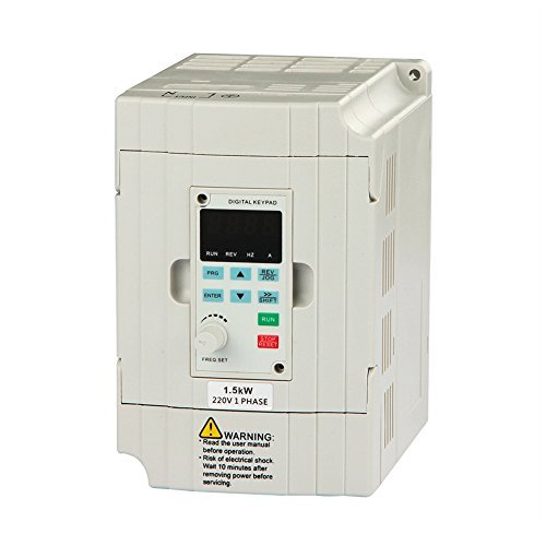

You might take a look at something like this:
http://www.ebay.com/itm/1-5KW-2HP-V...831131?hash=item23472a9fdb:g:XJ8AAOSw0vBUkjm0
as it has a speed potentiometer for a little faster adjustment, although most of the chinese VFDs will allow you to add your own auxiliary switches and pots. I've been running my mill and surface grinder on a similiar "cheapy" for years, with zero issues. They're actually quite versatile if you know how to program them. Mine is just in a small wooden cabinet with a couple of small holes drilled in the bottom for air flow. Dust has not been an issue, though if it were closer to my grinders, I would buy a roll of filter media to put around it.
The $100 Chinese VFD's are actually pretty cool for the money. You can remove the face plate and put a CAT 5 patch cable between the face plate and the VFD (which is mounted in a box) for remote run. Then you have the enclosed face plate with the pot switch mounted near your grinder for easy access.
And I could run one of these in reverse?
On chance your VFD or phase converter does not have reverse ability, its easily added a polarity reversal switch placed in 2 of the 3 motor leads.
Any way to tell in advance whether or not it's reverse capable?
You could probably download any manual of the vfd you choose before buying it.
A VFD typically will have 3 terminals that can be wired with a switch for fwd/reverse and 3 terminals that can be wired with a pot for remote speed control. most also have terminals that can be wired for remote on/off. so you wire a box with 2 switches and a knob right next to your grinder while your VFD is mounted out of the way and out of the dust.
So, one like this with a removable faceplate, it couldn't be reversed without adding another switch somewhere?
