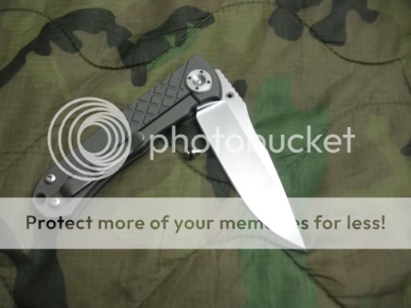

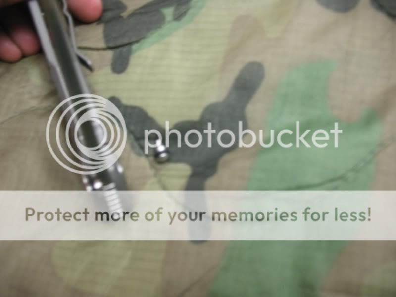

Not my pix, but remember these? :cool:
Chris did say they were looking into going to a one piece pressed in stud, I wonder if they have done that yet? :)

I agree with everything you've said, except now the Umnums have a single piece thumb stud. That picture you posted was from a soldier whose vehicle was blown up, and apparently there was a tolerance issue with the thumbstuds at that point. they were since fixed (but still two pieces), and then I believe they were replaced with single piece thumbstuds.

I remember Chris posting that sometime around June of 2010 the thumbstuds on the Umnumzaan switched to a one piece design.

I looked into the one piece stud, and it does seem your right :thumbup:
Hey guys – I am sorry it has taken so long to get back to you. Please believe me when I say I have started on this several times over and something always gets in the way!
The issue of the thumb lug problem of the very first batch of Umnumzaans is rather complex and the technicalities of it are difficult to describe so I am not going to go into detail. It revolves around an error on the handle fixture, and the way the lugs connect. Immediately we realized there was a problem, we altered the fixture and changed the tolerance of the connecting sections of the lugs so that they fit much closer. We do not know exactly how many knives we produced like this but our best estimate is well under 100. We have received fewer than 10 knives returned for this problem, and every Umnumzaan sent in for sharpening, refurbish etc. is checked. With these changes, the thumb lugs have been rock solid.
Since we always work to upgrade our engineering, Chris sought to improve the thumb lug which was already performing to all expectations. He designed the single bar thumb lug and we made them in-house during the first part of June. We do not have a day marked on the calendar as to when we started using them but estimate early July. There would have been a period of cross-over since the blades are slightly different for the two styles and the guys fitting would use whichever lug was appropriate as they worked through a batch of prepared blades.
And I say again – if you have a problem with one of our knives, you know we will make it good!
