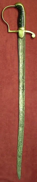

Since the bayonet blades were abundant we did see a few 19th century yataghan short swords like the Cadet short sword/Rice Surprise Party swords.
Link:
N2s
Link:
N2s
Tim Graham had done a nice post ACW short sword thread at SFI and had about twelve of them lined up. The '1878' must come from the Fagan listing.
