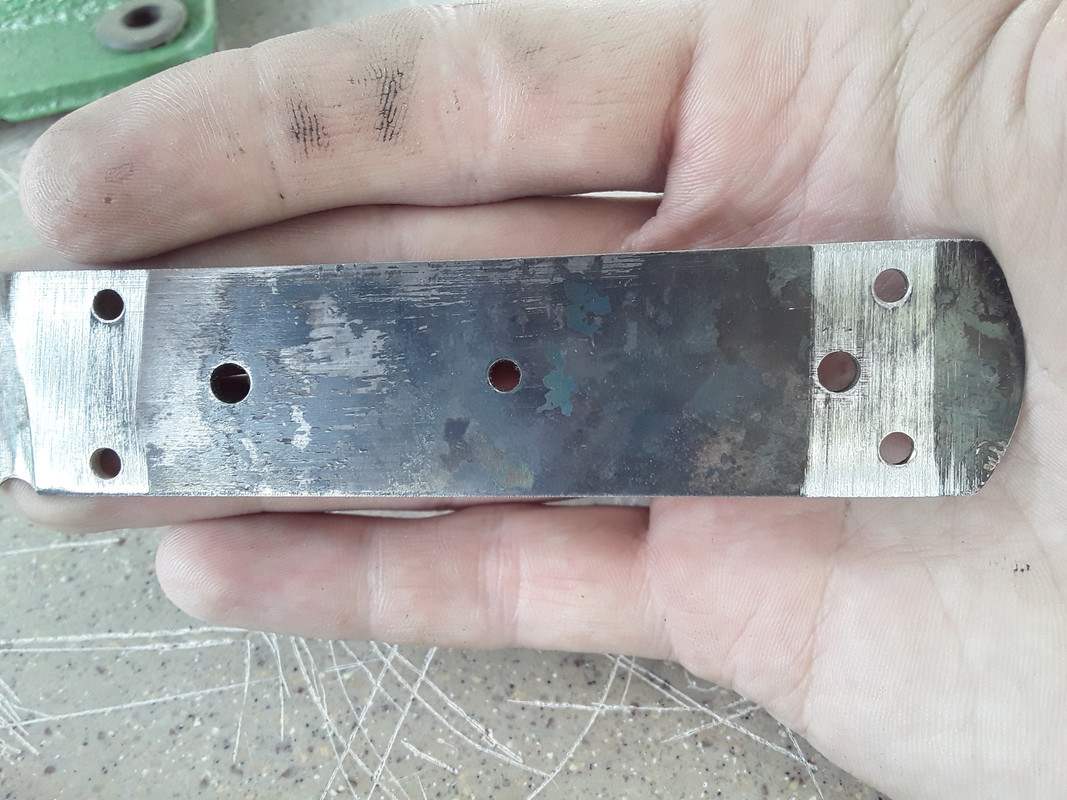

I have made a couple of kitchen knives with that same blade, they take a nice edge. I put some old flooring wood handle on one (from my grandparents house) and put some dyed box elder on the other for my wife. On both, I drilled an extra hole (as seen in the picture) so the pins could be smaller. Make a couple different ones to see what you like, and give them away as gifts:)

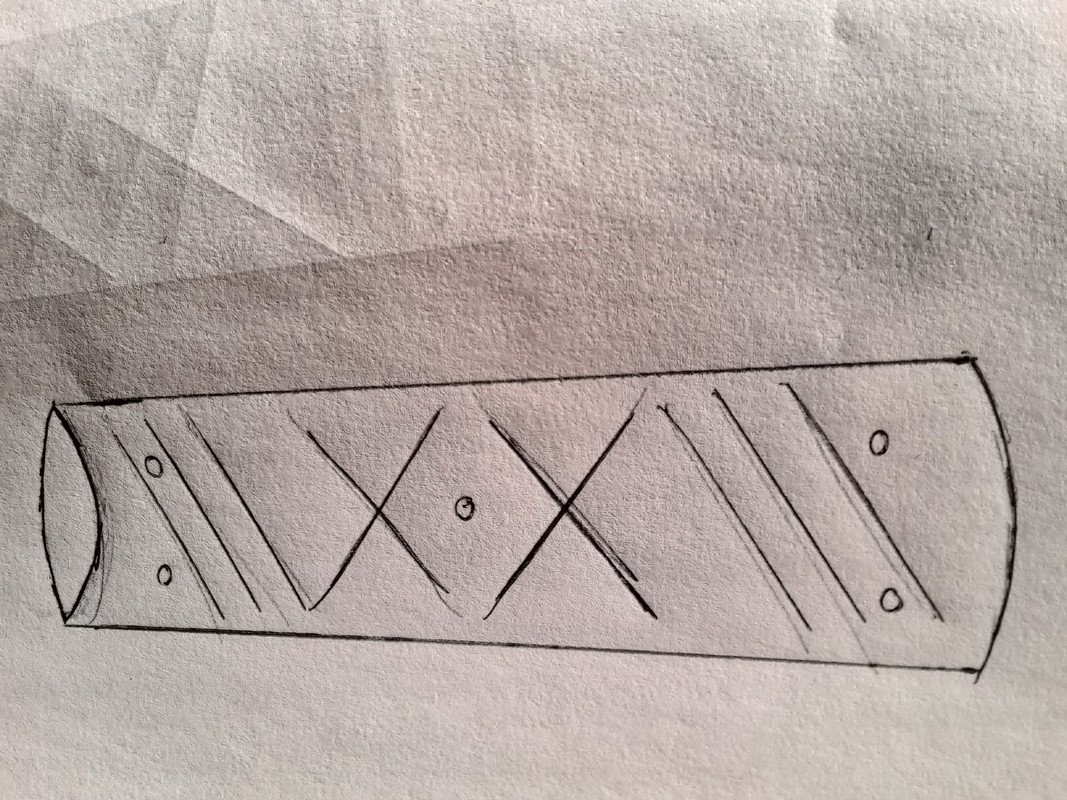

This is the idea I've currently got in my head.
I really like the 2 X's in the middle which seems to be a common way users would add a little extra grip to their knives, but I'm not sure about the diagonal grooves at each end.
For some reason I just can't get the handle of the German Nahkampfmesser our of my head with the 9 grooves in it's handle.
I don't know why but when I think of filing notches into a wooden handle for grip that knife pops into my head every single time.
It's completely unrelated, but it's something I can't get out of my head and feel compelled to do.
It would also look good with an x at each end and the 6 grooves in the middle, they could be at each end or in the middle and they could also be vertical too.
Which do you guys think would look better , ends or middle for the grooves and vertical or diagonal ?

Got it in today, and got the 1/8" holes drilled.

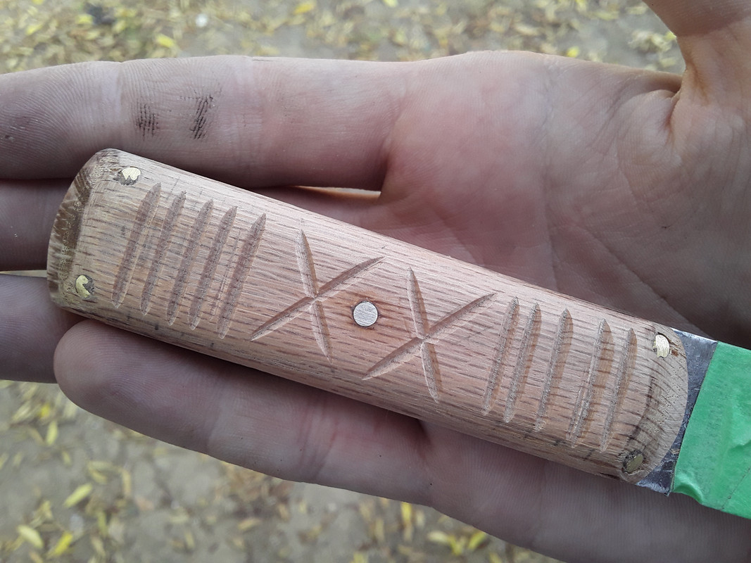

I think I'll do a practice run with the red oak and if I like it I'll just leave it.
The tough part (at least for me) is getting the edges even all around. How thick did you make the handles? Did you epoxy the wood or just pin it?
3/8" thickness for the scales, but slightly tapered down towards the blade.
These are just tacked on with super glue, so I can easily pop them off.
When I go to put handles on it for real I will use epoxy, unless I want to peen the pins a little which might be more authentic.

What particularly do you not like or feel the need to improve.
The heavily beveled front and back ends of the handle mostly, the wood blowout around the front and rear pin holes, and I radiused the front of the scales too much.
