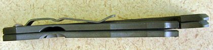

I am very impressed with the way the Umnumzaan in the Polish test performed. It went through all kinds of tough testing and it performed extremely well. After examining the knife, I have come to the conclusion that because it would not fail, it was modified to reduce lock tension and therefore fail the spine whack test. As I have said before, my knives always tell papa the truth when they come home!
This can be seen clearly in the photograph which shows the back handle slab of the “test” Umnumzaan (above, with clip attached) alongside the handle slab of the Umnumzaan that I have carried in my pocket every day for two years (below). The locking bar of the “test” knife does not lie as far over as that of my knife, showing that the tension on the lock bar has been reduced.
There continue to be comments implying mistrust of the Umnumzaan ceramic ball lock up system. The Umnumzaan is tough and any doubters of the strength of the ceramic ball need to do their homework on strength of materials pertaining to ceramic ball bearings. These balls are hard and tough. Example: put a ball on a steel plate and hit it with a 1 lb machinists hammer (pall peen). It indents the hammer and the steel plate and does not shatter. You can hit it hard enough, in fact, where it will drive itself into the plate completely. The small indentation caused by the ceramic ball in the lock ramp has no effect on the lock of the knife as has been speculated by some. That is merely because the steel is softer than the ball; it will only indent a small amount and not go any further. The Umnumzaan is the next step in the progression of the integral lock mechanism that I invented in 1987. It is an improvement over the Sebenza.

The knife surpassed expectation on the treatment it received – it failed because it was modified.
