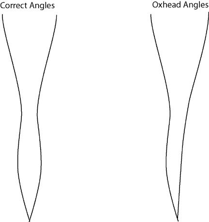

3. The ax head was mis-shaped according to how it should be in D. Cook's book. According to D. Cook, the angle formed by the ax blade should be steeper towards the bit, then shallower at the cheek and then steeper again towards the eye. It should never be completely flat, but always curving, because this helps keep the ax from getting stuck in the wood. I don't know how to describe this other than to do a picture, so here is a simple diagram:
Now, this is a bit exaggerated to illustrate what I am talking about, but the Oxhead is definitely not symetrical on both sides. This is hard to show in pictures because you really have to turn the blade in the light to get a feel for the contours.
I'm sure this could be corrected with some filing and/or grinding, but I really don't want to mess with that. I wouldn't mind having to sharpen the ax, but I really don't want to have to re-shape the head, so this is a significant problem for me.

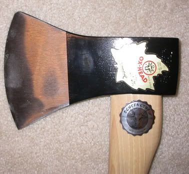

4. The corners of the bit do not seem shaped right. Once again, I refer to D. Cook's book, where he says that the corners of the bit should be slightly rounded so they don't chip.
Well, I don't know if this is typical of an Oxhead ax, but the one I received had one corner that was significantly rounded, and not rounded very uniformly either. To the point I thought it was actually chipped off at first. The other corner wasn't rounded off at all. Again, this could probably be corrected with some filing and such, but I don't want to have to mess with all of that on a brand new ax. I want it made right from the get go. Also, I don't know if you can tell from the pciture below or not, but look at the way the lighting shows the contours on the ax. They certainly don't look uniform to me like the pictures on the website show.
Here is a picture, notice the difference between the top corner and the lower corner of the bit, as well as the irregular contours on the cheek of the ax:

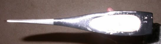

Cliff, here is a picture of the top profile of the ax, since you requested it:
Sorry about the poor quality photos.

It is rare to get solid handle/head alignment on modern axes, that issue in particular can be compensated in use by adjusting where you hold the axe on the grip to put the center of the edge in line. Note how straight handles would act in this test for example. A more serious problem is the alignment of the edge with the handle, it should split the handle directly in the center if you look down the grip, the Forest and Wildlife Bruks I had were significantly skewed, the maul however is dead center.
It looked as if they put just one side of the bit against a grinder and ground a chisel type edge onto the bit, instead of having a bevel on both sides of the bit.
Not only that, but there was a severe burr on the opposite side of the bit from where the bevel was. The bevel wasn't even uniform or sharp by any means.
This you can fix with 10-15 minutes with a coarse file. I know it sucks to have to do a serious amount of work on an axe before you use it but once you start using an axe no matter how careful you are glances will happen, hidden bad pin knots can ruin you day and an idiot with a spike will mess up the best axe. I always take a file and coarse/fine stone with me when I take an axe into the wood.
...the Oxhead is definitely not symetrical on both sides.
This is serious, how much so depends on the nature/extent of the asymmetry. The more uneven the bit, the more the force will be on one side than the other, this will cause the blade to want to turn in the cut and prevent clean and even lines.
...the one I received had one corner that was significantly rounded, and not rounded very uniformly either.
This is common due to the lack of consistency in the grinding in such axes.
...the bit should not have very much curve in it.
There are many bit patterns, some are flatter. You can adjust this with sharpening by working more towards the center. This is give and take on this like all other aspects, a really highly curved bit sinks in smoother but it less effective in terms of number of hits because the cut line isn't uniform in depth. There isn't a right/wrong here, Cook is just expressing his opinion on what he feels is the best smoothness/efficient compromise.
I don't know if I'm just being too harsh on this ax or not.
If you were to give the same axe to a woodsmen one generation ago he would likely just call it useless junk. Now you have to accept a lot more problems especially with head/handle alignment. However it takes a *lot* of skill with an axe to even note that these problems exist. Starting off you just have to develop the precision and power. Once you develop the ability to cut without stair casing then you will notice small changes in design.
I would suggest that you fix up the edge and use the axe, don't wait until you find the perfect axe before starting to develop your skills. In general anyway you need more than one axe. I generally take two. One I have highly optomized with a nice clean and thin bit for felling high quality wood and another that I use to clear out a knot, clip off limbs, trim off really thick bark, or work through a bad section of wood.
