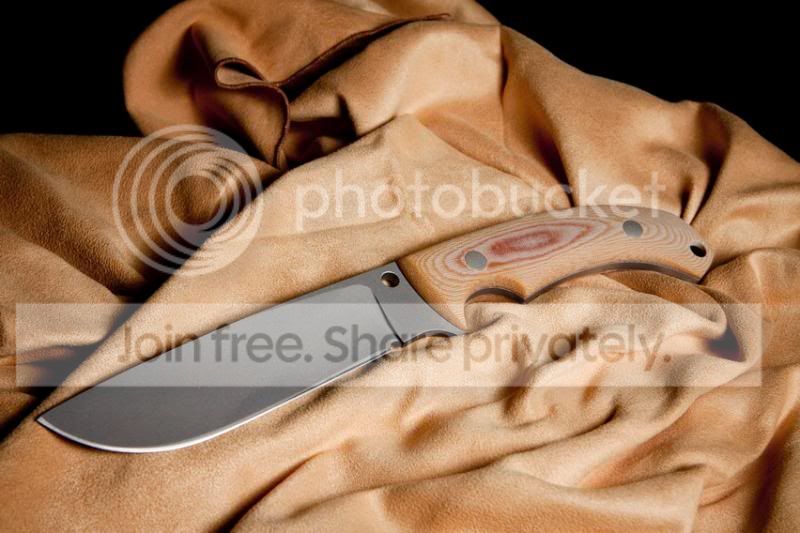

Here's one I just finished up in CPM D2, stonewash finish....

Tell us(me) about how you achieve this finish!
That finish was done by finishing the blade on the grinder to 400 grit, then it was blasted with 80 grit garnet media with the blaster set to 90 PSI, then it was tumbled in a vibratory tumbler with coarse ceramic media from Mcmaster Carr.
Thanks!
Love the looks of the blasted and tumbled blades...Do you you the triangular or cylindrical ceramic?
Matt, thank you. Yep, that's the material. Really pricey, but I'm liking it.
Sunny, I actually use a combination of both, 50/50. Get the coarse.
