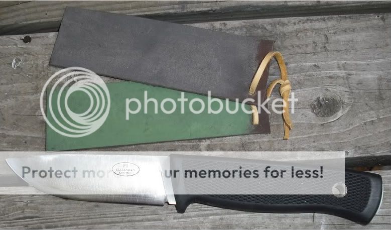

I've been using these & they've worked well so far;
1 1/2" X 4 1/2" stiff leather with Bark River compound.
I have a couple spares you can have if you'd like to try them.
Cliff
