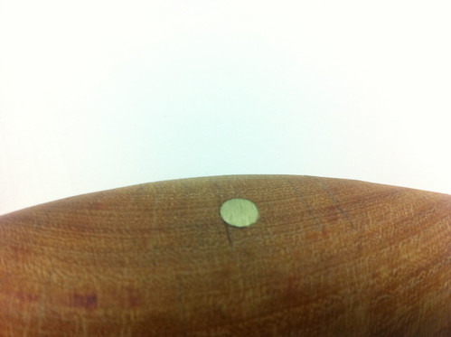

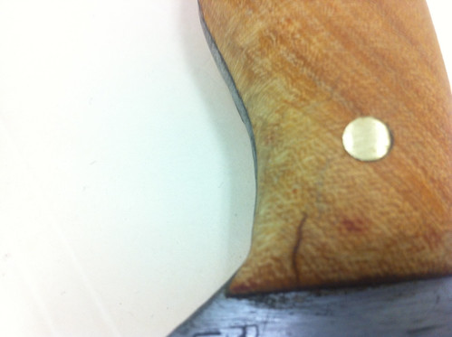

Perhaps I didn't inspect it close enough but these handles appear to have cracked after the fact. What is the main culpret.
My guess is overheating during sanding.
Not dry enough to begin with - the wood was a chunk of bowl stock from Rockler.
Could the epoxy on its own cause this?
Here are a couple of pics.
Untitled by rlibson, on Flickr
This was my first attempt at a wood handle more or less and I want to make sure this doesn't happen on the next one.

I have an abundance of Osage Orange and enjoy it as a hobby wood. For sure it will crack and I find if I dont want cracking in the finished piece I must be sure that there is no sign of cracks after it has cured and use that piece specifically. I generally cut it split it and let it season for a year then pick the pieces that have not cracked and much of it will. When I turn it on my lathe if Im making candle stick holders it almost always cracks some time after it is turned and it adds to the character of the piece. Im new to knife making and will try some for my scales knowing I will have to pick a piece with caution if I want it free of cracks. I also plan to use it for annealing when I get my kiln made at some point as it is dense and does burn HOT. It plays hell on a chain saw.
It appears to be cut end grain, which is more likely to crack. My guess is like you said, maybe too much moisture content in the original bowl blank. When you cut it down, it shrank some more as it dried.

Looks to me like the wood still had a lot of moisture in it. I keep all wood for at least a year in my shop before I use it. It's a good idea to check wood with a moisture meter before it's used.
With the cracks you have, you can put super glue on them and then sand smooth with sharp belts. You should be ok.
I'd say it was a moisture problem also. I've noticed a lot of knifemakers having problem with "turning" wood sold at the specialty harwood stores. I mostly harvest my own, preferring native species to import anyways. I cut and cured out enough osage back in 2001 for probably 800 handles and have only had a few split/check like that. I harvested the osage in late April so not so sure the season is that critical, but getting the ends sealed definitely is. I check mine by weight and sometimes they take a few years to level out, but has always been worth the wait. A well ventilated attic works really well for a lazy man's kiln.
Your best bet with that one is the superglue approach Tom described. Always use fresh sharp belts at slow speeds with oily woods like osage. I usually rough out my shapes pretty close with saw and rasp before going to the belt sander....hogging causes clogging!

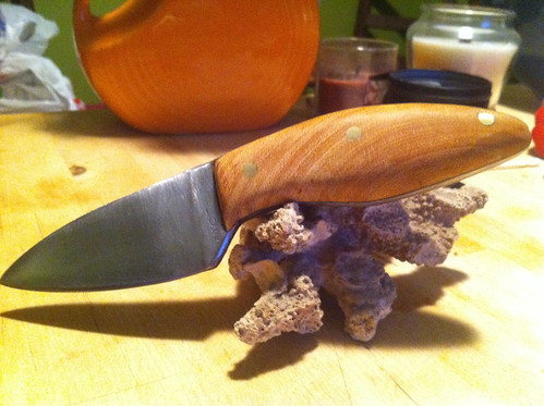

Here is a pic of it as it stands now - pretty much my first take at shaping a handle...still might take down the thickness a bit and at some point I need to figure out tang tapering cause it's butt heavy.

I am quickly finding out -that patience is one of the key virtues of knife making.
Dan is right about turning green wood. I got into knife-making through woodworking. I have been turning wood for over 10 years and I try to always turn my bowls green ( a little wet). I use one of these: http://www.woodcraft.com/Product/2080242/28380/Sonin-Digital-Moisture-Meter.aspx , and I recommend one to anyone using wood handles that aren't stabilized. As to the Osage (we call it horse-apple), it looks like you had some moisture still and you caused differential drying. Use CA on it and the cracks will stop you can also put a little sawdust in the crack first and then flood with CA. I love the look of the wood but I absolutely hate cutting it. I cut a ton of it though, nobody around here wants them on their property. I charge to take it down, and then sell it to turners and carvers, cut and waxed. I have about 400 board feet of it drying right now to use for knife handles, and I won't sell it to a knife-maker until it is fully cured because of your exact situation. Put the rest up in a barn or shed and forget about it for a year and check it again. It takes 1 year per inch to air dry. Hope some of this helped and feel free to ask about anything else. Good luck and have fun, by the way the knife looks cool.
