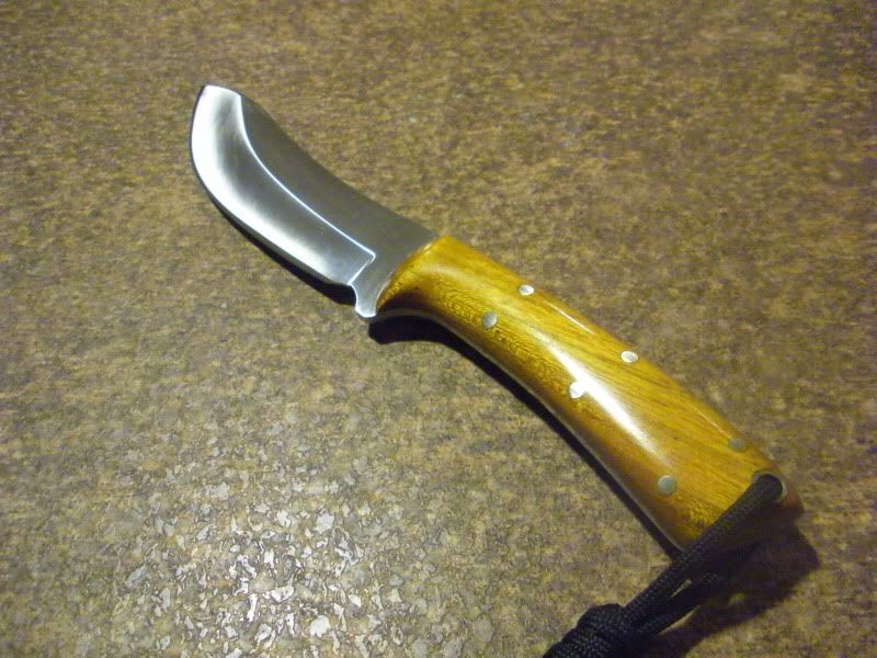

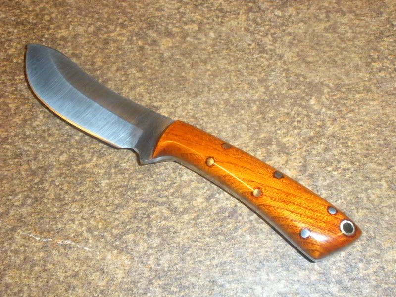

These are my experiences with Osage Orange...and so far, I love it. Probably my favorite working wood thus far! They have all been wetsanded to 2000 grit. The 3rd handle got a light wipe of light brown leather dye and one fine, thin coat of Tru Oil.

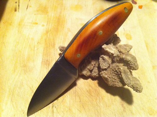

Refinishing a Case XX Ridgeback:
Bullnose skinner:
And the "mess up" of the previous picture. I burned a pin while sanding, so I took my woodburning tool and scorched around all the pins and the tube to give it an aged look.

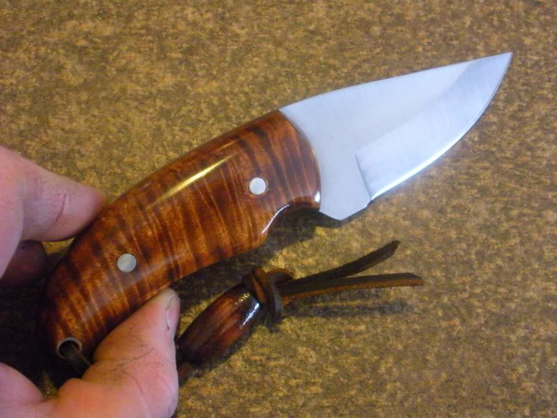

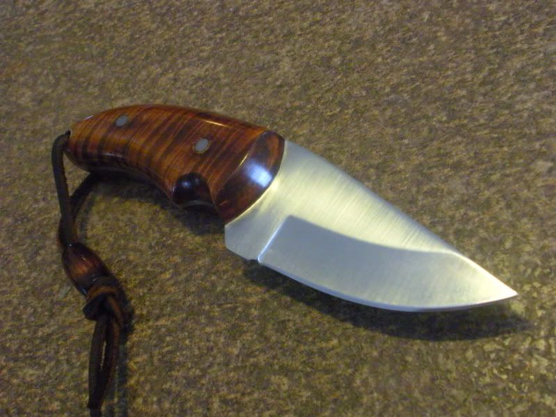

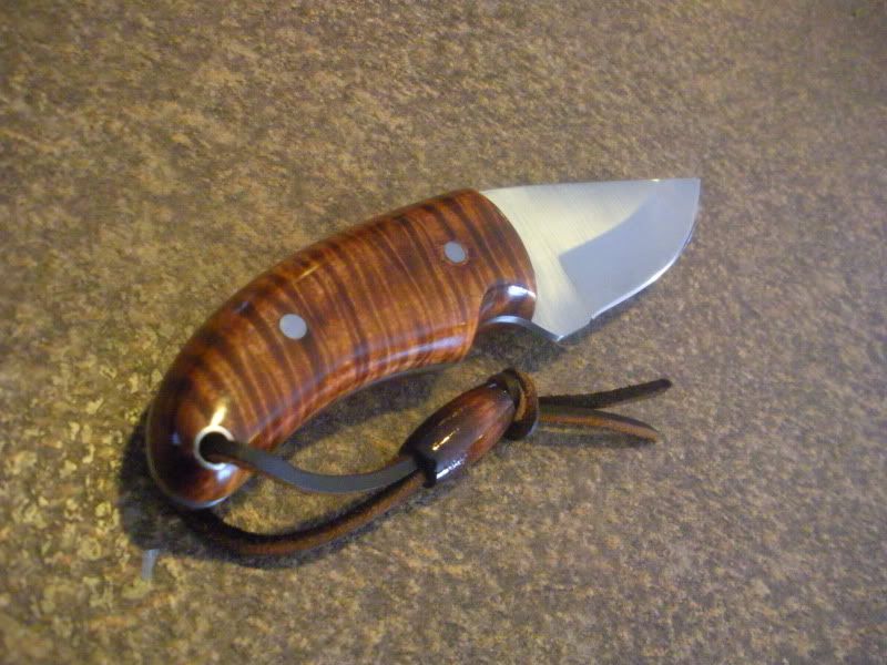

This is my first and so far only experience with curly maple, exhibition grade.
What I did was to dry sand to 600 grit. Then I wetsanded the wood from 800, 1000, 2000. Once complete, I gave it a light coat or 2 of leather dye (same color used on the sheath). Once dry, I took some ultra fine steel wool and lightly rubbed the handle, this polished away a bit of the dye leaving the curls a nicer dark color. Once this was complete, then I started in with my Tru Oil finish. Several coats rubbed into the wood with a ultra fine steel wool pass after each one dried. After all was dry and ready, it got a coating of meguiars carnuba wax and a intense hand buff using a microfiber towel.
