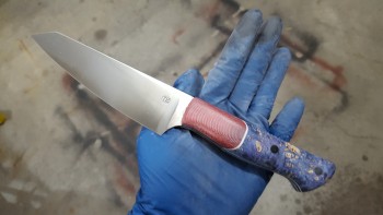

Been a while.
Japanese honesuki style blade with a western handle
AEB-L stainless
Red linen micarta
White G10 liner
Stabilized blue dye buckeye burl
My first one with dovetailed scales into the bolsters. Blade complete for around a year waiting for a handle.
First hidden pin too in the bolster.

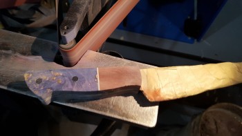

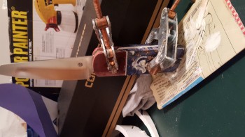

Glued up.

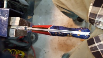

Profiled

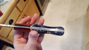

Hand wet sanding. Bolsters look symmetrical Yay.
Clean 800 grit. I'll do about 6 coats of tru oil after this.

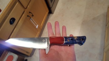

Ok here is 5 coats of tru oil. One more and I'll put the final sharpening. Think I'll try a saya for it to. That will be a first too.
Shite cellphone pics sorry.
I've switched at from CA to the tru oil. Actually easier and I think the less glossy end product looks better.
