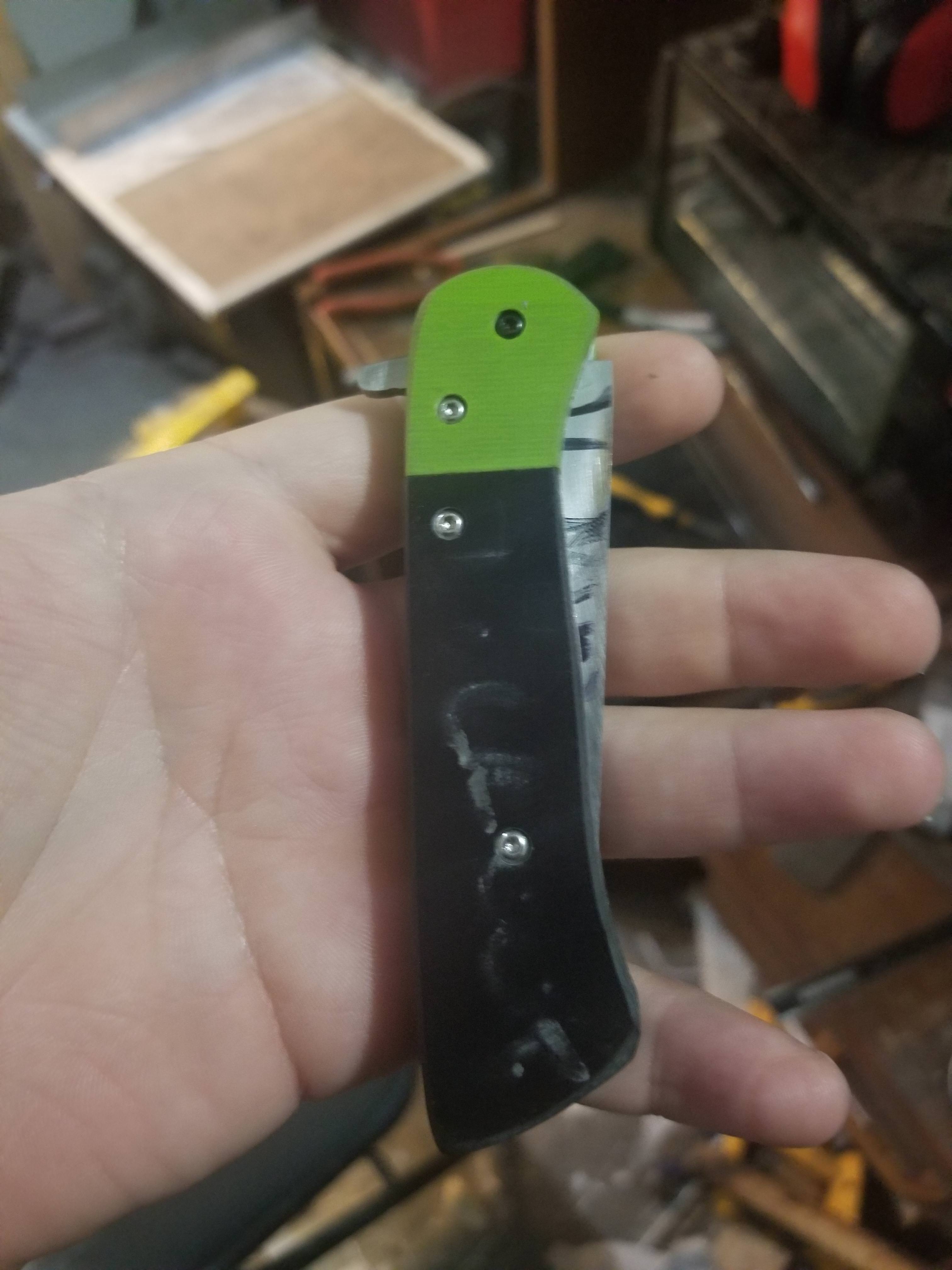

VERY long way to go on this guy. But I'm seriously loving making folders. Been using PB washers but think.im gonna switch to bearings
Looks fantastic, is that
Is that one of the "whitepaper" san mai steels? What did you do for your heat treat and etch? Where do you get yours from?
Thanks,
Josh
Thanks. It is The takefu white steel core with 22 mild steel laminations. I buy from dictum or workshop heaven.
I forge and the. heat treat in a forge and quench in straight water and then flash temper to 63-64 rc. as taught to my by Murray Carter.
Etch is 3:1 fc. quick etch. Just a few seconds.
