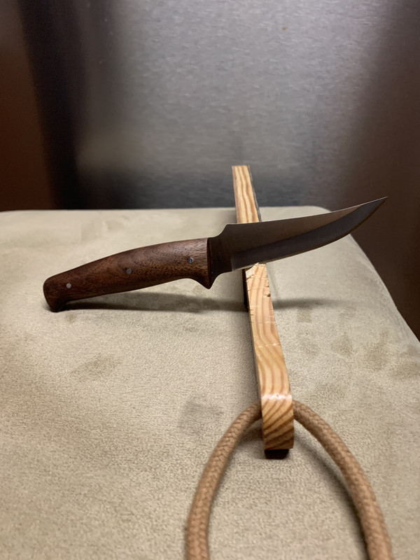

Finished this one today. 6in Santoku in AEBL and Canarywood.
