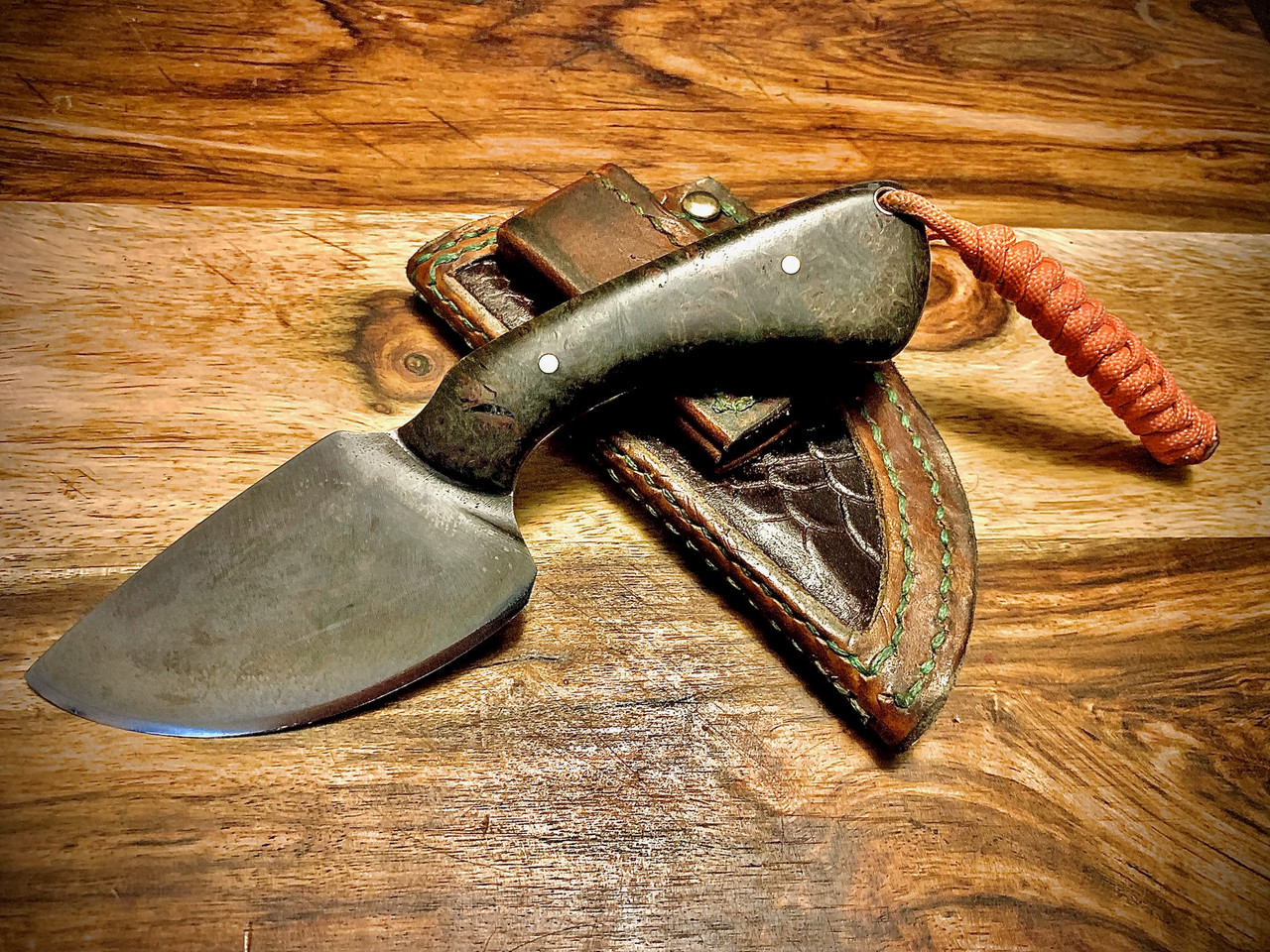

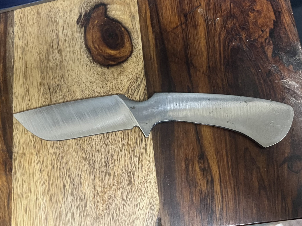

I had gotten a complaint out of one of the skinners I had made. The guy said the skinner was too fat bellied to cut around the anus of a deer. I took a blank of this design and cut it down to match his specs. The thumb groove is perfect for controlling the blade as you are skinning and caping a deer. Never really had any issues with stress risers. The blades always come out of the temper around 60-65HRC and the spine is plenty thick. The blade itself is rather small.
I was going to do a distal taper to the tip and make it like a scalpel, for those intricate cuts.

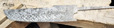

Here is the fun project - a kiritsuki gyuto from a massive billet of 420/1070 san-mai. It is heavily forged to give the edge a flame pattern.
The Kiritsuki-gyuto was a project I have set aside for a while. I had a dozen of the big billets made in Brazil a while back, and have only made two blades from them so far. I put a shot of the roughed out blank from the billet. Grinding a 1/4" thick billet of 420 and 1070 core down to a thin kitchen knife takes time and careful attention to the core position to make both sides even. Think I nailed this one. This one is now ready for HT and final grinding.kiritsuki.jpgkiritsuli 7.jpgkiritsuli 6.jpgkiritsuli 5.jpgkiritsuli 4.jpgkiritsuli 3.jpgkiritsuli 2.jpgkiritsuli 1.jpgBillet 9.jpgBillet 10.jpg
