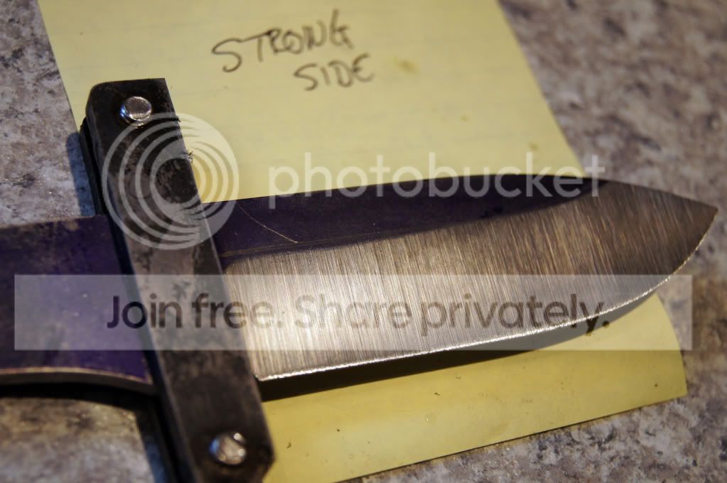

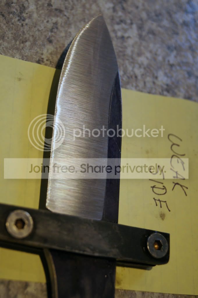

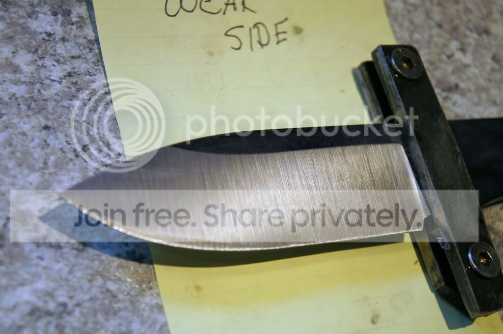

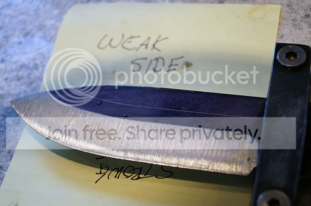

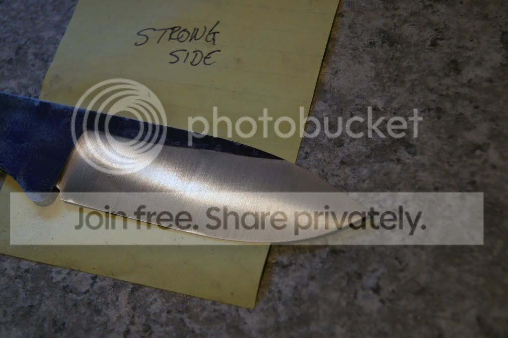

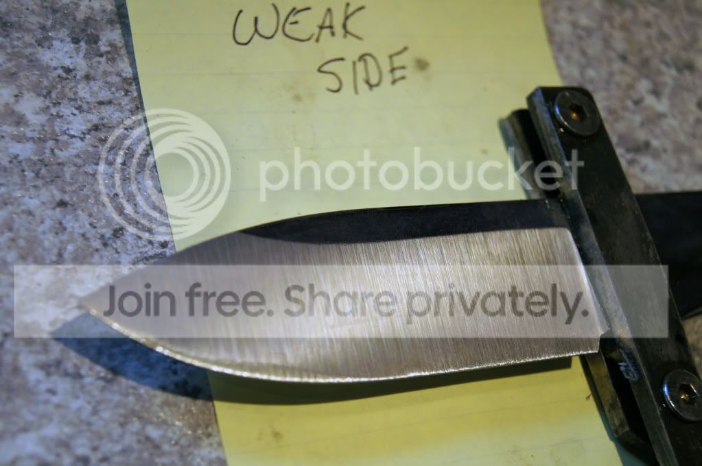

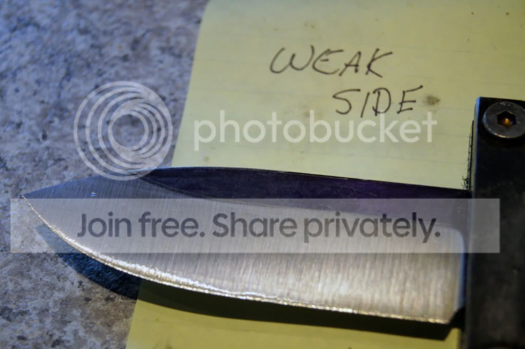

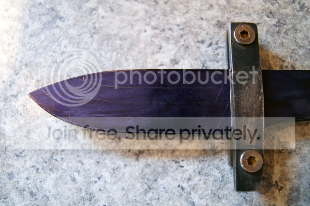

OK so I made a fair number of changes, and things worked out much better this time. Only problem is I change so many things at once I don't know what fixed the problem:confused: either way this is what I I did this morning, there are 18 pictures showing what I did.

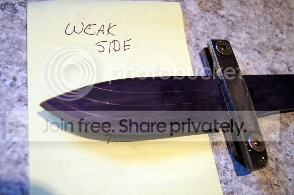

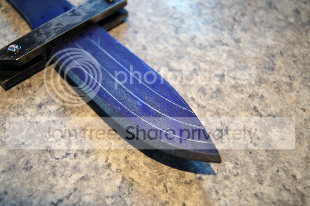

Laid out some grind lines

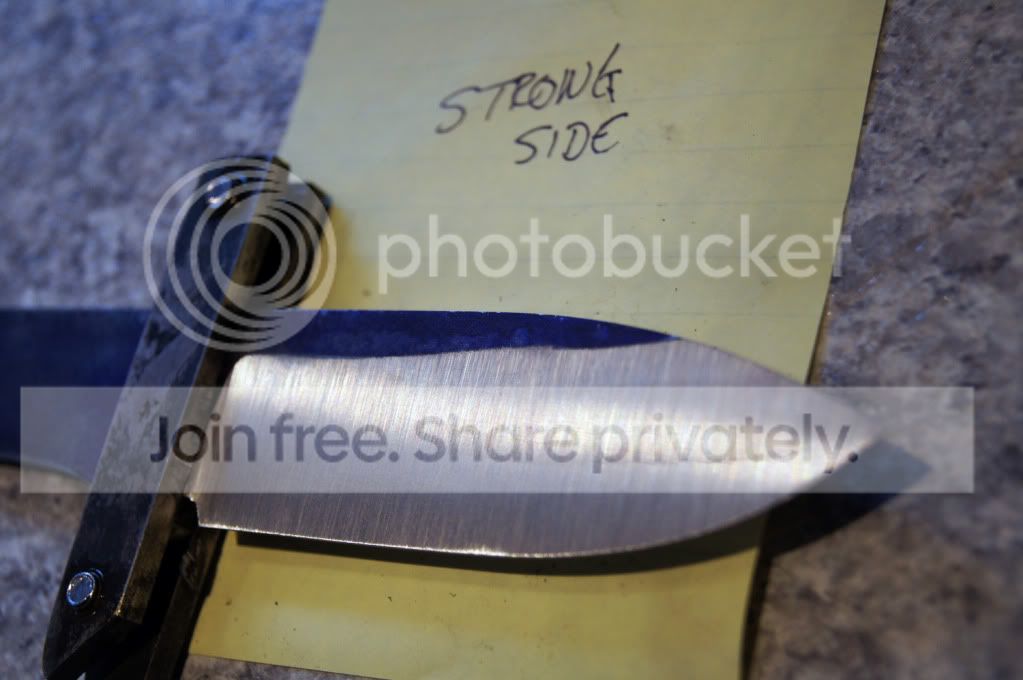

Using a used 36 grit belt I broke in the edges at about 45° stopping just above my edge thickness marks
strong side
Weak side
I then switched to a new 36 and started working my way up to my guide marks

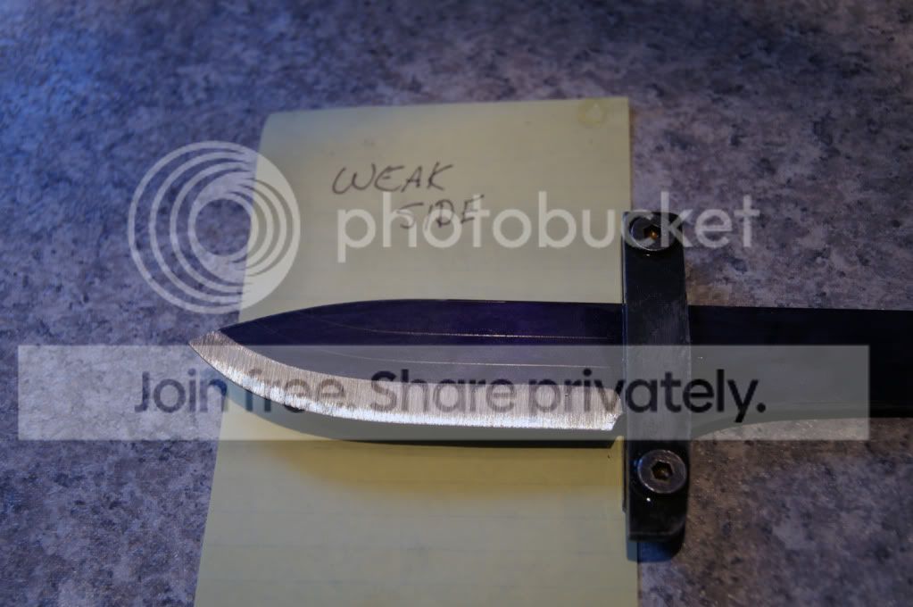

weak side

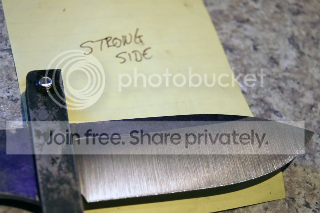

strong side (yeah wobbly grind, it appears that my strong side is weak today, but that side is the worst of my elbows:o)

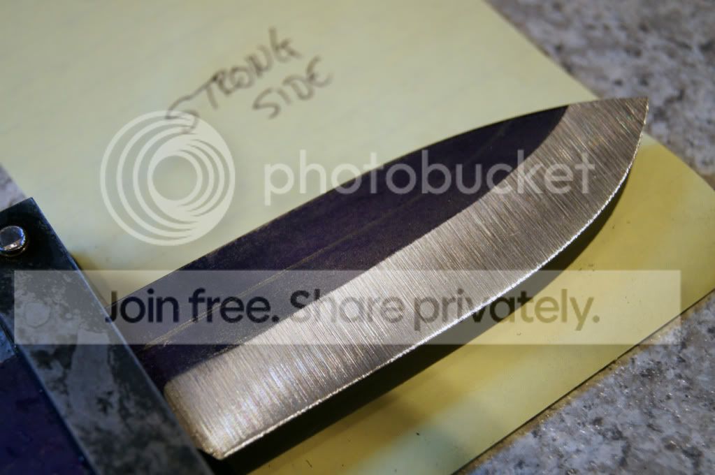

Then I started working up through the grits, 60-120-220-320. I started the progression at 60% of full speed and dropped 10% with each grit. I used a very light touch on each grit too.

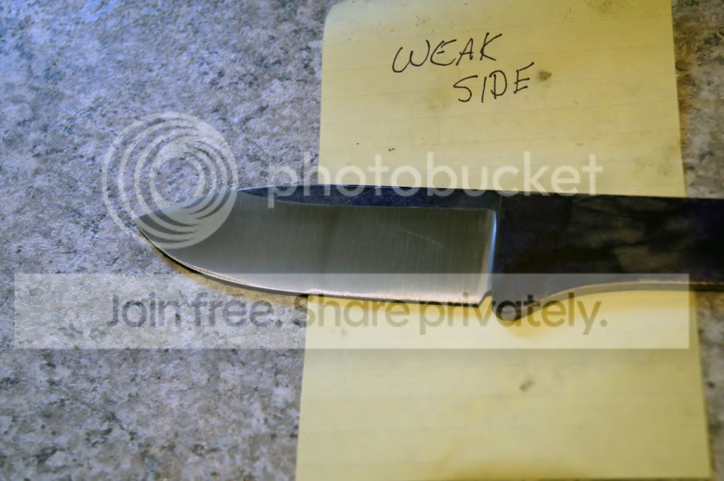

Weak side
Strong Side

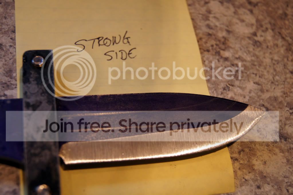

You will notice a nice little bobble here, someone came in the driveway and honked the horn while I was grinding, startling me:grumpy: I don't know who they were and they just wanted directions, but I gave them a nice lecture on startling someone while they were operating machinery, then I told them where to go:p
The grind lines are sharp even in the bobbled area, I am going to take a file and see if I can even that out without taking too much material off. Like I said I don't know what tip it was that made the difference, but one did so I will just thank everyone equally for their input on this. I have two other knives I want to get cut out and ground today so I best get back out there.

The best advice I ever received on grinding: grind the the tip along with the entire radius of a blade "after" the straight area of the bevel is close to rough ground. The single straight draw with out the twist and turn used to shape the tip is best done by itself. Once the straight bevels are close to complete its much easier to grind the tip.

From the picture you posted it looks like a control issue rather than a belt issue. It is easy to let the blade rock ever so slightly. This will wash out the grind lines. Once you get to 220 grit or maybe 400 I go to hand sanding. This brings it all in evenly, at least for me.
I agree with you, it was a problem with the operator and not the machine:( I think it may have been a combination of the speed and pressure causing the blade to rock and washout the grind line, both operator errors. I changed a bunch of things so I can't say what in particular was the true cause:o Combine too much pressure and belt speed with my numb hands it is real easy to see how the blade can twist like you say. It also explains why what would normally be my strong side being the weak side yesterday because my dominate arm has been the worst of the two for numbness over the last couple of days
