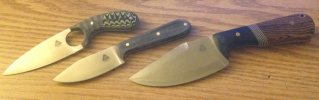

Good evening friends. Today saw progress on three knives in AEB-L and one in 15N20.
AEB-L: Mini Kiridashi with natural canvas Micarta scales, Spear point ringer with black and yellow layered G10 and black canvas Micarta bolsters, EDBowie with black canvas Micarta scales
15N20: SkinnyFat Bowie with Bocote scales, layered G10 spacer, and black canvas Micarta bolsters
These are, as of yet, destined for the exchange.
And I also textured the scales on the 15N20 EDBowie which will be going to Kevin Cleary and then Jake at Canadian Cutting Edge.
Had a few things on the go today so not as much shop time as I would have liked. Nevertheless, these ones are inching their way to completion:
Today I made a sheath for the tanto which just sold, an Edge-C wharncliffe commission, which used up my last piece of Python Micarta. I nearly finished the spear point ringer, and made good progress on the Bowies. Poor little kiridashi. You'll have your turn.
