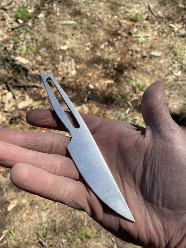

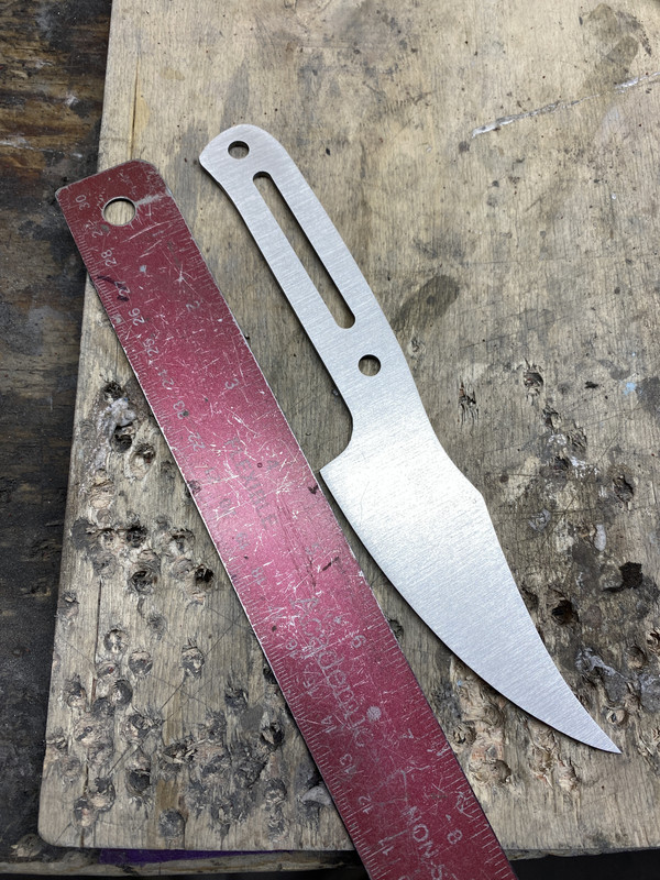

Was asked for a sharpfinger quite a while back. I ended up putting that run on hold but will make it from a chef knife. Here is the blank cut out, AEB-L, 63 RC.

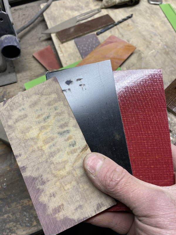

Thank you. They are fun to make. Yesterday I woke up at 7 am, after only 5 hours sleep. I tried to go back to sleep, but when that wasn't happening I played maybe a dozen chess game, and went to the shop. It was a slow, start. I thought I was going to hand sand and refine the two I put together Monday, but found myself putting the first steps together on over half a dozen blades, most of which are expected by you and a few other guys, but in the frenzy of making up scale combos, I had this itch to clean up my cut-off in various materials. So not only did I start a bunch of knives, but I also have a few other scale combos I put together for future use.

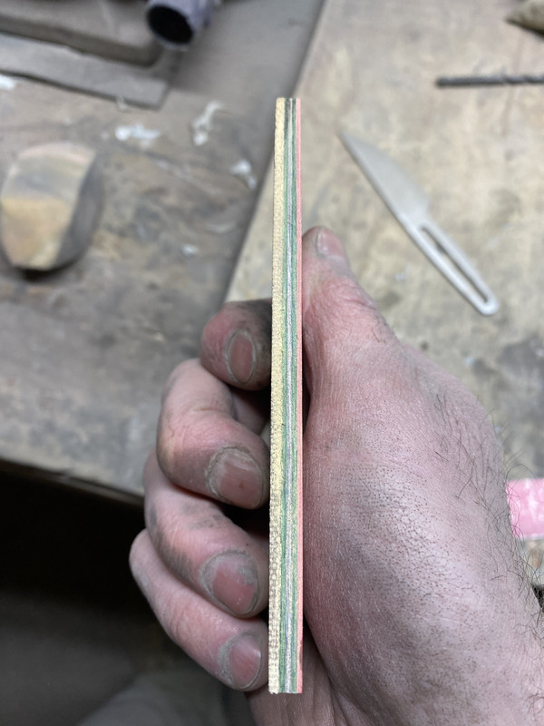

Black Micarta Bolster, Fat Carbon Gold Marbled Carbon Fiber inlay with green G10 liners and spacers, and python Micarta main scale segment. Not planned for anything specific yet. Will be fairly thin scales, as I started with 3/8" thickness python Micarta, and split it down the middle on the table saw.

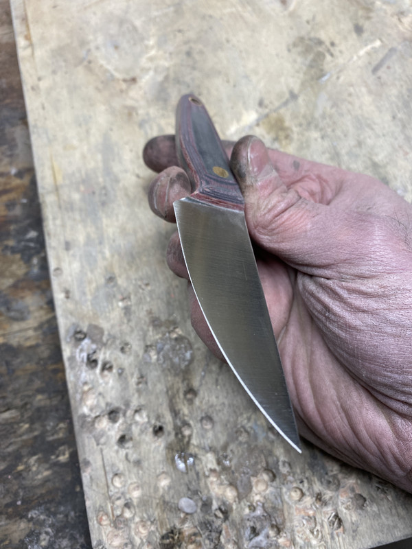

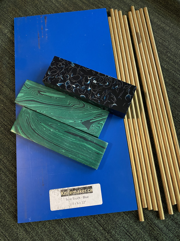

Here's a pair of totally weird scales I made for a Prevail. From Bolster to butt, stabilized box elder, Dymalux, firedog Micarta, spalted tamarind, Dymalux, firedog Micarta, stabilized mango. I got the handle assembled, cured, and rough shaped already, and filled the remaining voids with superglue, which I will clean up next time I work on the knife.

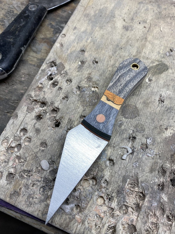

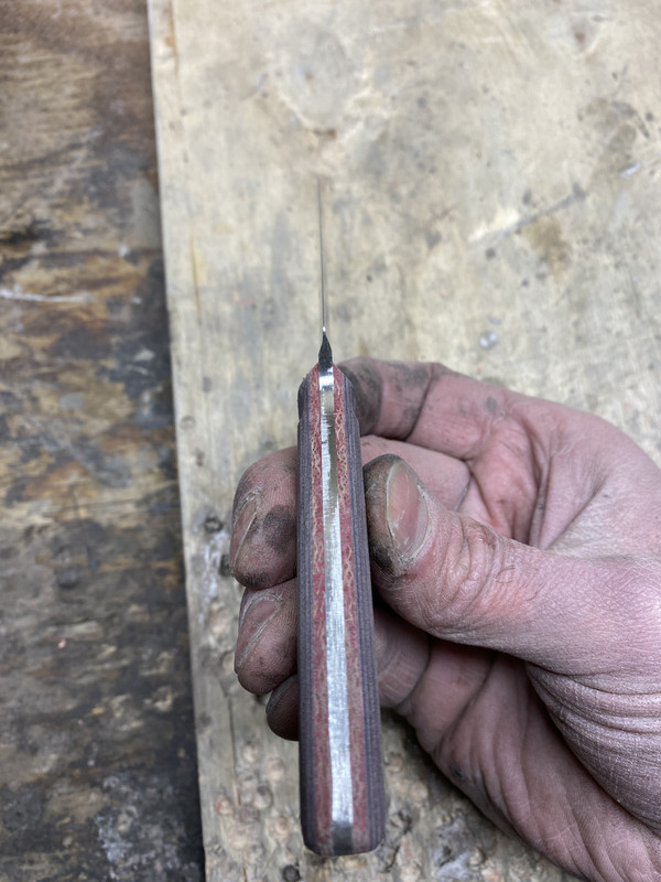

Small knives take little time, so I did go pretty far on the "Sharpfinger left over". Still needs clean up, but note the table saw split and grinder flattened red burlap Micarta liners to go with the suretouch scales. Part of me thinks I will cut the blade down from 3 1/2" down to maybe three, and do a drop point with a swedge, but that's only an idea for now.

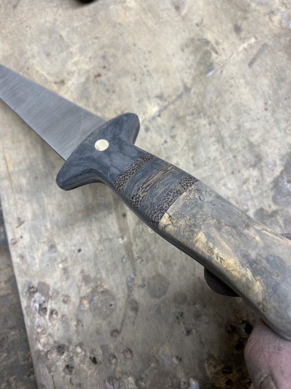

Significant shaping on the fancy dagger. I was given creative license on this one as well, and I had a piece of left over stabilized poplar burl from the Prevail I started, so that is the butt segment, then an inlay of alternating stabilized black palm x 3, dark matter gold marbled CF x 2, and a bolster of black marbled carbon fiber. Note that I alternated the grain orientation of the center black palm strip relative to the two outer ones.
