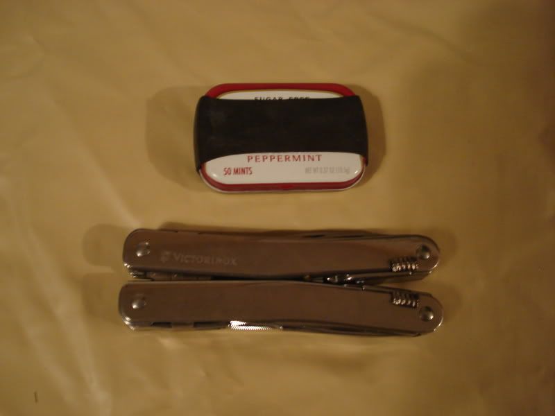

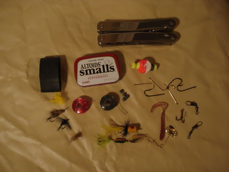

I’ve recently been interested in building a few new 'pocket' type kits for outdoor survival as well as for EDC. I’ve decided to build smaller modules so I can mix and match my load-out depending on the activity at hand (an orienteering & signalling kit, one for medical/first aid, one for fire-building, etc)—let’s use an ‘Altoids’ tin as a size reference and consider a casual seven day lifespan with greater longevity if you really conserve resources. My current focus is to build a functional fishing kit, and I am looking for suggestions.
How much line do you feel is required to be functional? I’m sure any length would be better than nothing at all, but how much line would you pack to feel reasonably comfortable that you could catch your dinner for a week? Is dental floss a more versatile option (I’ve never used it for fishing)?
Hooks and sinkers: how many of each? Would you pack a bobber or do you feel it is easy enough to improvise in the field? Would you pack some kind of lure(s) or just use local insects and critter guts?
Please share your fishing kit ideas! Much appreciated and thanks! :)

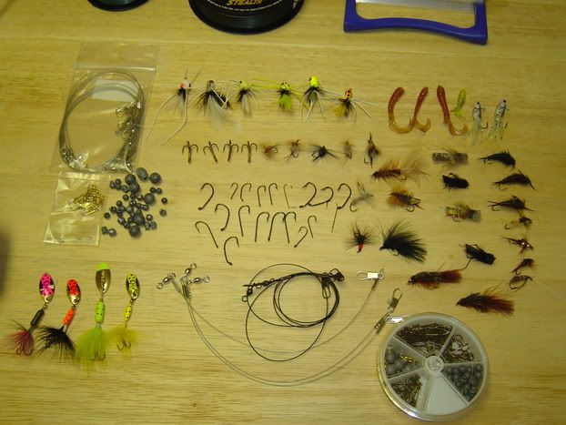

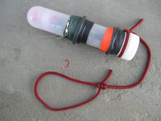

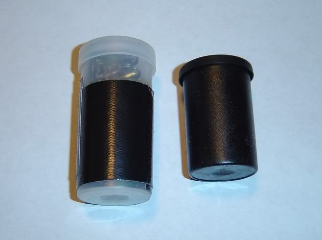

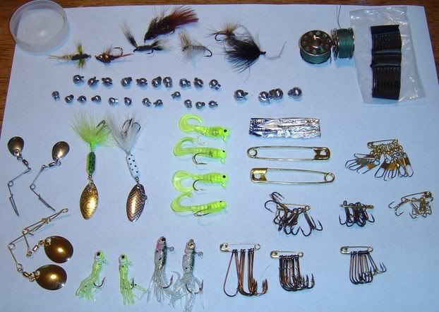

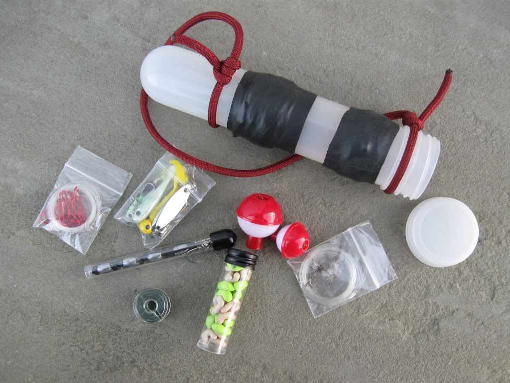

A few kits I have made:
ROCK6
I dont have a kit but am planning on making one and using it some time this year. I wont put any sinkers or hooks in it except a couple large hook for bank lines. I plan on loading it with jigs of different types and sizes. Sinkers and hooks do not need to be separated. Ive caught lots of fish with a gob of worm or shad parts hooked onto a jig.
around the outside:
50' of 50# test spider wire w/ small swivel & size 8 Matzuo snelled hook
2 -15' 50# test spider wire drop lines w/ size 8 Matzuo snelled hooks
12" bright orange surveying tape to mark drop line locations
12" parachord wirst lanyard
on the inside:
14-size 8 Matzuo snelled hooks
6 - artifical baits
1 - spinner bait
2 - bobbers (i have replaced these plastic bobbers shown w/ solid foam ones - better design and won't break if steped on)
screw eye for improvised fishing pole
4 - 1/16oz rubber core sinkers
3 - small swivels
5 - 24" 15# flourcarbon leaders
2 dryflies
Bobin of 50# test spider wire
brekeley artificial power bait gulp alive
