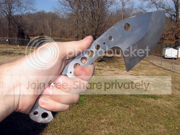

Got my grinder mostly finished and actually had the house to myself for a few hours today so I decided to have at it.

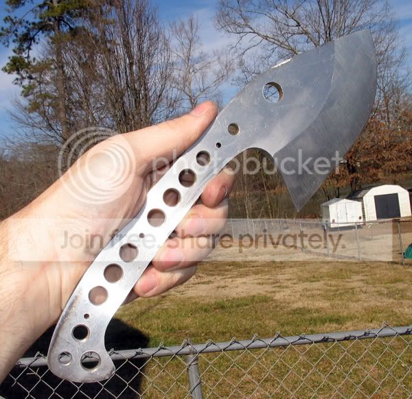

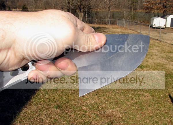

The top one is a skinning hatchet that I profiled out over 2 years ago before I had to shelve knifemaking due to family illness and birth of my youngest daughter.
I lived in Alaska for 8+ years and saw the usefulness of a small hatchet for skinning very large game (i.e. moose, bear and such) and have wanted to make my own twist on it. It will have a burlap micarta handle that goes all the way past the series of holes and will give you 2 distinct grips.
Grip one is a traditional hatchet grip for separating joints and other tasks that require a bit of umph.
Grip 2 allows you to choke up on the blade and use the large curve for separating skin from meat, fat from meat, and such. The forward hole is there to give you an anchor point for your thumb while using this grip. I'm excited to see this one coming along. It will take a while to finish since it gets pushed aside for everything else.

DUDE that first pic of the hatchet is so deceiving! I did not read the text till I scrolled down and looked at all the pics then it's like BLAMMO! LOOK AT THIS HATCHET IN MY HAND!!! I 100% dig it.
That hatchet is cool! So are the rest but the hatchet is out there. Hope you do some more work on it so you can share the finished product with us. Thanks for sharing. John

I like the hatchet very much. The only small thing that bugs me is that point at the guard cut-out. Very scary, to me anyway. If it's not absolutely essential (I never skinned anything) I would at least put a very small radius on there.

When designing this I crossed an ULU and one of the Gransfor Bruks small hatchets to come up withe basic shape. I'll have to admit that any sort of point right at the hand always concerns me but I couldn't come up with a way to address that and keep the overall function. When I get this one done I'm going to play with it quite a bit. I work with a bunch of deer hunters and will see if I can coerce one of them into letting me help them skin a deer with it for testing. I'll probably send it after that to some individuals for testing.
I appreciate the comments and the concerns.
Charlie
