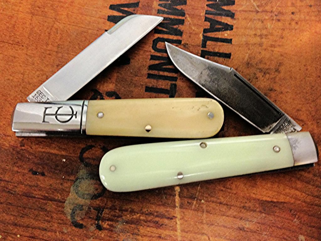

im having a hard time trying to wrap my head around the huge diffrence in patina in 2 knives off the same pattern....
both knives are carried in the same manner
handled only by me
never used in food prep
it seems i can look @ the boy's knife & it will rust. i even have some pitting on the bolsters.
my "charlow" on the other hand was apparently quenched in unicorn tears during the heat treat. it has never once even "look" like it was going to get a patina on it
If nothing else, I'd not be surprised if a small difference in blade finish made most of that difference.^^ Looks as if the patinated blade may have more irregularities in the finish (grind marks/pits/etc.). That's why polishing a blade can go a long way toward minimizing rusting and/or patination of a blade.
Assuming same steel (1095), small differences in heat treat are also known to affect corrosion resistance/patina potential, to some degree.
Also, just one exposure to a particular oxidizing agent (vinegar, fruit acids, etc.) can sometimes affect how fast/how much the blade will darken later. I'm seeing this on my Schrade 8OT, on which I forced a vinegar/hot water patina on the clip blade. Left the other two blades alone. Aside from some small spotting on the un-patinated blades, they look essentially like they did when new. The patinated clip blade has continued to darken gradually, past the initial exposure.
