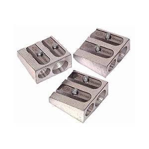

cheat..... put a pencil sharpener in your fire kit and just use that on any pencil sized sticks.....makes damn fine shavings and if you look around hard enough you can actually find pencil sharpeners made of magnesium so if it's really being contrary, you can scrape the edges a bit to increase your odds.....
I like the 2 hole kind that can use large or small sticks LOL.... search " KUM 2-hole Pencil Sharpener Magnesium Alloy "
What a fantastic idea!
