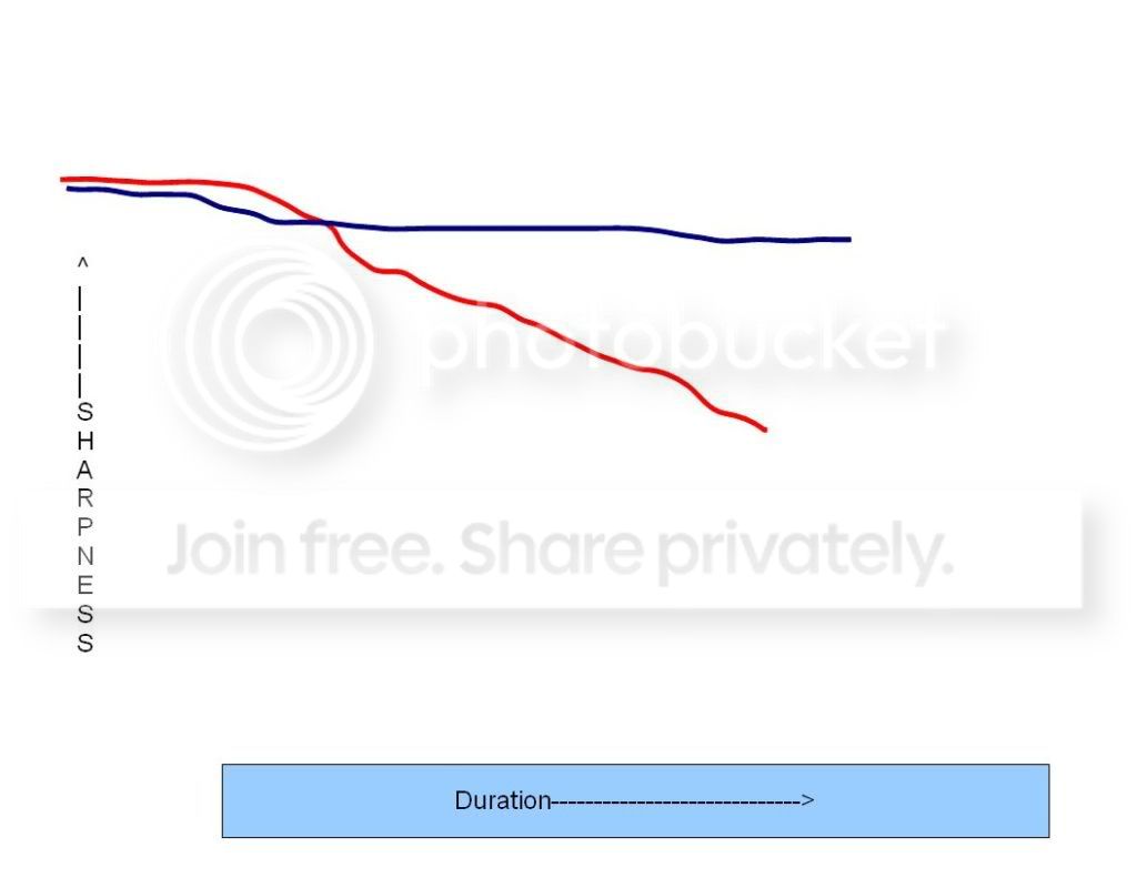

To a certain extent, that is going to depend on the type of cutting and type of edge you use.
Some alloys maintain a highly polished razor edge longer than than other alloys. But the other alloys maintain a good cutting edge longer.
Here's an example of the above behavior. The red holds a highly polished razor edge longer, but the blue holds a working edge longer.

That's an interesting graph. Is it a hypothetical graph to illustrate your point, or real data? I'm interested in what causes a fine edge to hold on a bit, then have both the fine edge and working edge drop so fast.
Alloy composition, heat treatment, and carbide distribution throughout the steel matrix. Just a guess on my part. I do know that there are optimal ways to turn a steel into a super steel performance wise.
