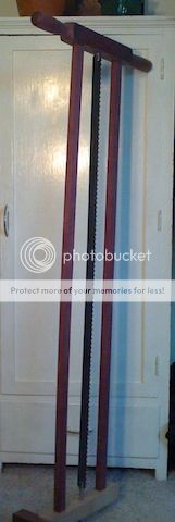

The bandsaw is way more important than the other power tools. You can resaw by hand but . . .
well here is a hand saw for resawing
You don’t need the bandsaw until you get into planks more than about three or four feet long then you wind up needing to dig a pit and get a helper for the other end of the saw other wise it is just too tedious to follow the lines.
