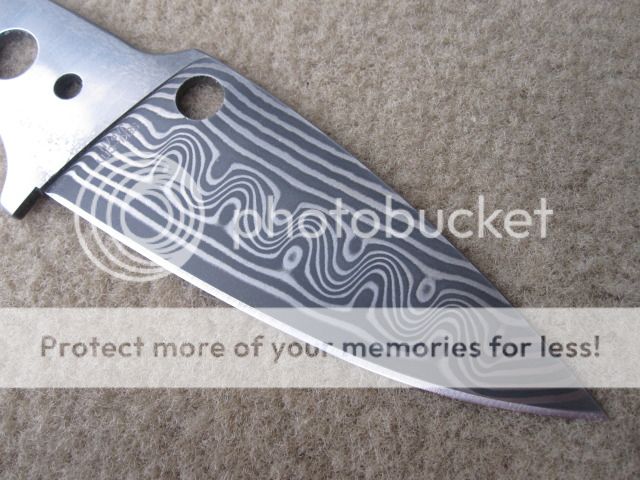

You cant just disregard the Suminagashi (I dont call that one damascus) - its the best looking of the lot:D
