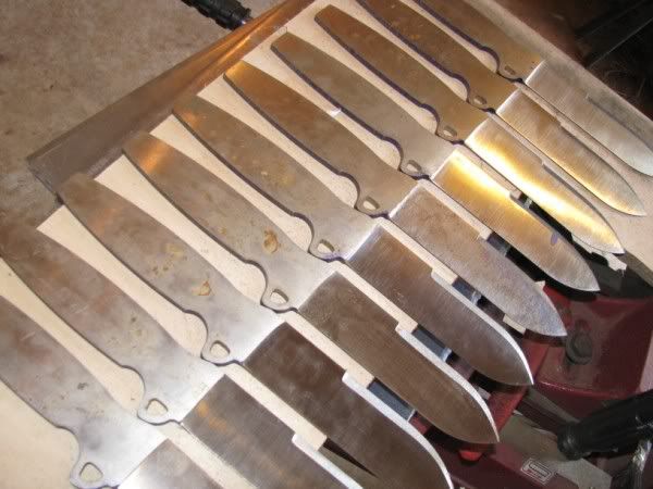

A shot of some recent work. These have had the handles drilled and all holes countersunk (540 drill press operations) since this picture was taken. I've also taken the grind to a higher grit. All I have left to do is contour the rear of the handle and file in the thumb grooves and these will be ready for heat treat.

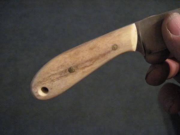

Here is one that holds a bit of a special spot for me. I worked on the blade and a very good friend of mine fitted up the guard and cleaned up some parts on the knife. He did this for me many years ago and he passed away last year. I just finished up the knife and I'll be taking it to Colorado next month to hunt elk.
I have a lot of knives made by him but this is one of the only ones that we both had a part in.
The knifemaker was George Englebretson. He was a fantastic artist and is sorely missed by many in the knifemaking community around here.

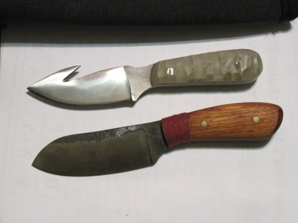

Here are some pictures of a couple of knives that I have just about finished. I still have to make sheaths for them and get them out the door but at least I'm making some headway.

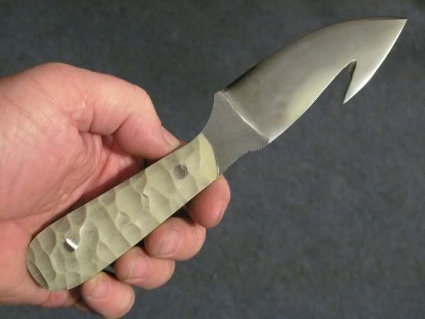

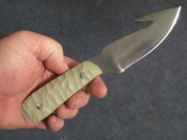

The one on top was made at the request of a friend. He wanted a "tactical pig splitter". He hunts hogs pretty regularly and wanted a knife with a guthook (my first) and a handle that wouldn't let his hand slip. Here is what we came up with. It is 154CM with a heavily textured G10 handle.

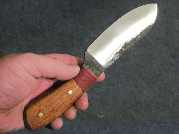

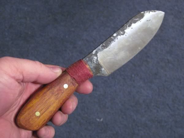

The knife below that is my first forged knife. It is nearly 3/16" at the spin but has a nice thin edge. It is 1070 with hickory handles and a hemp cord wrap at the top of the handle. I am going to soak the cord with epoxy to seal it. I'm planning to make some sort of rawhide/period style sheath for this one.

I like that textured G10 a lot. You chose a great color for it and I'd be interested in seeing how it felt in hand. Your friend will be happy with it and I hope he puts it to good use.
Now on to the real beauty of that forged blade. You did a great job with it, IMO. I'm a HUGE fan of forged finished knives. I like the blade design, it kind of reminds me of a mix between a nessmuk and a sheepsfoot design. I would love to see that same knife but with some sort of hemp wrap in green, since I'm a sucker for all things green :) I can't wait to see the sheath you come up with on this one. You have a knack for creating sheaths that match perfectly for the knife, especially for period type stuff as this knife is.
