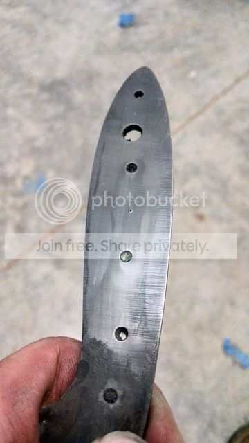

Ive made two knives out of this w2. Both had to be heat treated twice in order to get the blade hard all along the edge. Even though they are stock removal ive done the thermal cycling to refine grain. Ive used two different methods on 8 different coupons. Today I get anything to go past 40 on the Rockwell tester except on piece. I'm quenching in parks 50.

Here is a blade tang that was clean and left to soak at 1500 for 10 minutes. It shows some banding which I though was decarb, but after removing .040" it's still there and it's soft. Hopefully this picture shows it. The banding test soft and I get a hardness of 55-57 on the rest of it. The band's between the holes and on the left towards the top is one small dark looking line that is soft. It's like this all through the blade. This handle piece turned into a test coupon once I broke the blade to see what the grain looked like. It seemed to be fine grain.

Ryan, you're not alone. Not sure where you got yours, but a few years ago, Aldo received some W2 from Germany that had those exact symptoms. Seems to be a hit or miss thing, the few .140" bars I got from the newer batch harden quite well. But I have heard that there are issues with the some of the W2 (older as well as newer batch).
Maybe misidentified steel? It's possible you over refined the steel, making it very difficult to get past the nose quenching, but your other tests should have resulted in hardened steel.
Is this steel relatively new? Aldo had a bad batch of W2 several years ago, but he made that right.

This is what I was afraid of. I knew about the issues with the older steel. I've seen a few grumblings issues with the new stuff, but no one has come right out to say there was an issue or offered a solution if they ever did find the problem. I've called njsb twice but no answer. I was hoping to post here and someone tell me I was missing one major detail. This bar is .140 and bought in may or June.

I just got off the phone with a gentleman at NJSB. He said they had a bad batch and this may have been a straggler piece. They are sending me a new bar. I spent 18-20 hours in the shop yesterday doing nothing but trying to harden this steel. And I'm back at it today. Before I left the shop last night I had quenched with varying hold times anywhere from 1380-1650. I will have to look at my notes but I did the steel as it came and varying thermal/normalizing cycles with different coupons. I realize the thicker piece didn't harden either, but I'm convinced I'm not messing up. Two completely different steels with completely different processes hardened fine yesterday. I've read table salt melts at 1474
