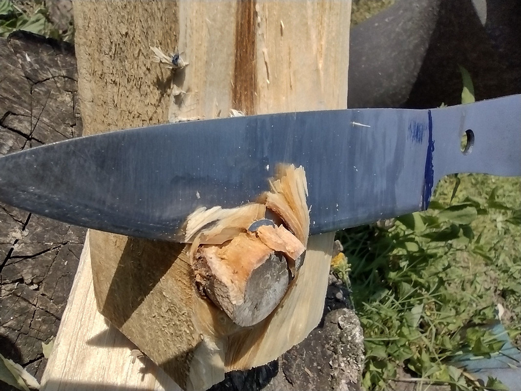

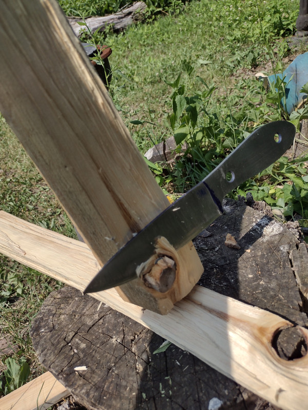

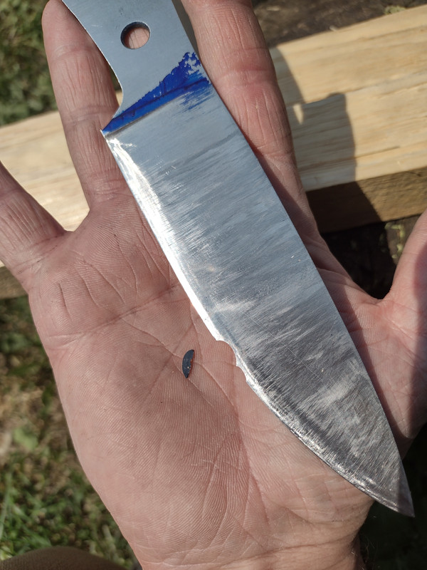

I think everyone focuses on steel WAY too much!
It's the least important of the three.
Geometry, and Heat Treatment are more important, in My opinion.....
Take This example, this was yesterday....bright beautiful day outside.....
This is Cruwear, arguably one of the best knife steels available. I'm fortunate to have had this blade heat-treated by one of the Best in the the country. Optimizing it for a hard, slicing knife.
62-63hrc. Proper tempering, Cryo, etc., etc....
Geometry......My Geometry.
About .010" bte.
Around 12 degrees per side, secondary bevels.
This was Sharp, if it were a kitchen knife.
You could feel it slowly, gently enter your thumb, and you didn't mind....that kind of sharp.
Well...... Application. I'm going to add a Fourth to what's important..... Application is also more important than steel choice.
You don't batton very thin, very hard knives into hard pine knots.
I break my knives,
so You don't/shouldn't have to..... :/
