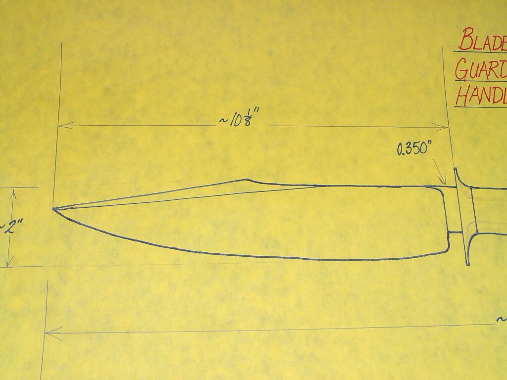

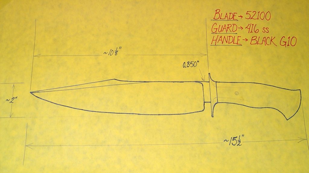

You guys up for the mother of all fighting Bowie Projects :)
Many of you remember the very successful Fighter project Nick and I did
This is a similar knife but only on Steroids & Growth Hormone :)
I have long quested for the ultimate Fighting Bowie and I have been gifted to call some of the best makers in the world my friends
Long hours of discussion and testing have lead us down the road to radical Distal Taper , points that lend themselves to brutal back cuts and sweeping bellies that slash like a sickle
This piece has the best of everything I could ask for in every conceivable option

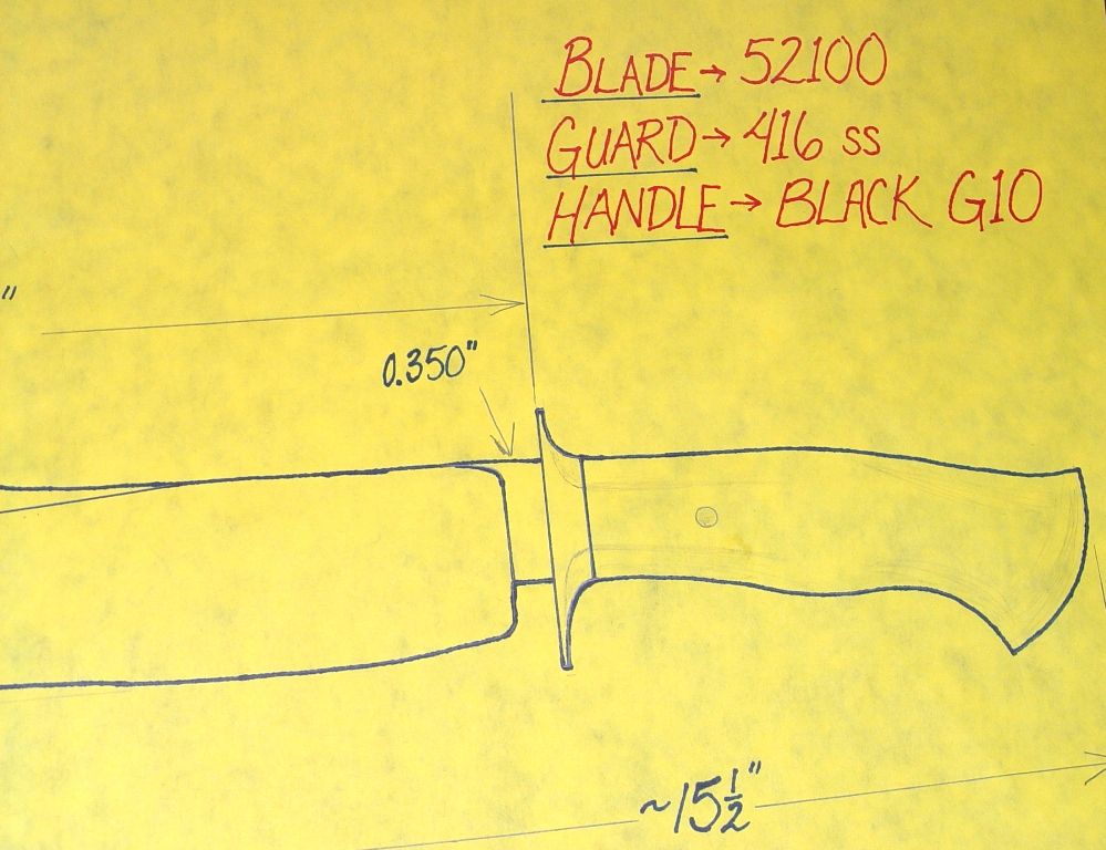

A contoured black G 10 handle like only Nick and a few others can do, a stainless slimmed down guard for the right amount of protection with out over kill.
This is a performance driven piece bar none and all I can say is that its gonna do it all.
There is a reason you do not see these project knives up on the chopping block often and that is because they are hard to let go of :)
This piece will chop like a cleaver , pierce like a dagger and back cut with the best of them
Combined with Nicks attention to detail and wicked heat treat this blade will surly go down as one of the best interpretations of a Fighting Bowie ever made
The steel will be 52100
If your looking for a fancy paper weight please do not apply
If your looking for an all out performance Fighting Bowie this piece will ring your bell hard
There will only be 12 of these made plus the Proto
The plan is to get the Proto to me for a video introduction and than off to the great Paul Long for leather than it will be on display at the Arkansas show with Nick and Paul
With out further a due
The Birth of Perfection
It looks like a blade for the devils ice skates :)
A blade designed for nothing but all out performance

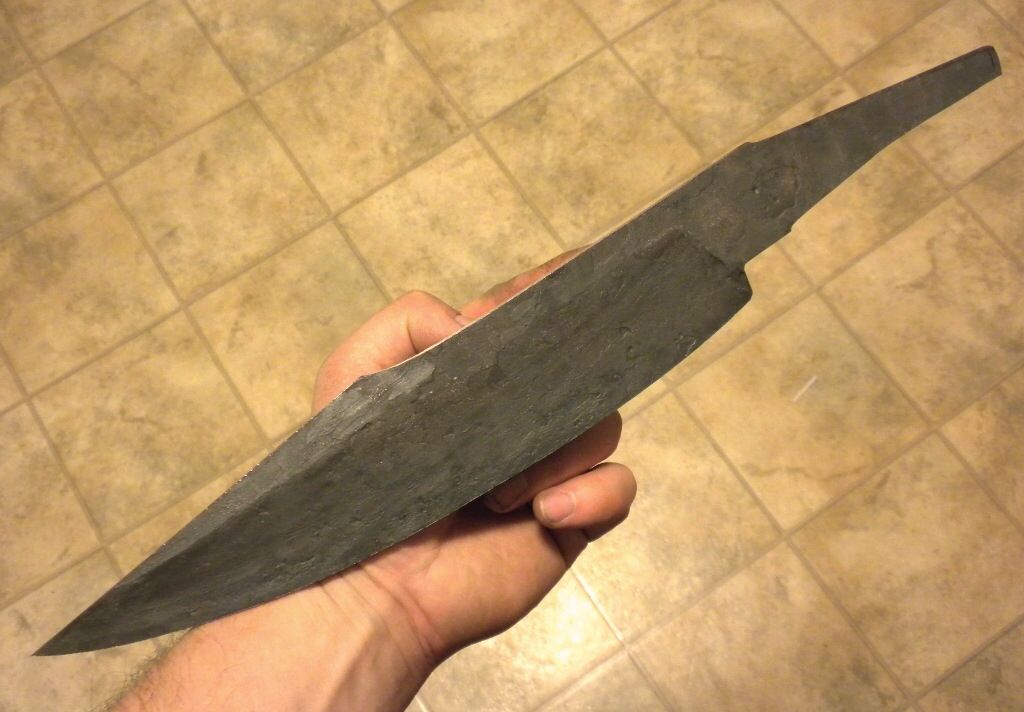

nice,
the grind lines on the picture looks better than the drawing ,
just a little flat on the top spine , compared to the full grind on the drawing
but that is my humble opinion

The drawing looks a little wonky because I went back over my pencil sketch with a fine point marker, and the marker bled A LOT. The lines will actually be smooth! ;)

***edited to add*** For what it's worth.... that pic of the blade in my hand is as forged, with about 1/16" buzzed off the profile with the grinder. It started off as 1-3/4" round stock from Ms Ray Kirk. The way the blade sits in that photo, it is 3/8" thick at the ricasso, about 0.060 at the edge, with the distal taper and clip all hammered in. :)
